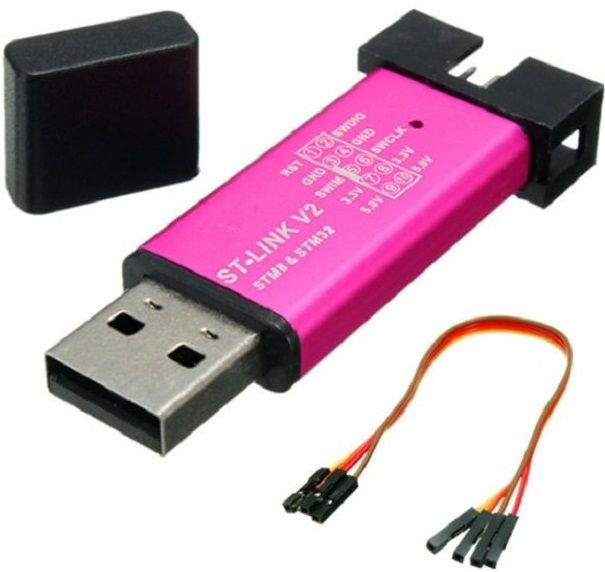

External ST-link used to connect STM32 board
How STM32 MCU flashing is working in NUCLEO-F031K6 without making BOOT0=HIGH? BOOT0 is always LOW in NUCLEO-F031K6 (Any STM32 board)
External ST-link programmer:
>>CubeProgrammer throws an Error "Error: No STM32 target found!". It works fine with BOOT0=HIGH.
Wouldn't that be indicative that code you are put on the device is ballsing up the pins related to the debug interface, disabling or entering a low power mode we they are turned off completely?
#UpHillSkiing
S.Kamath
Reflashed MCU with BOOT0=1 with SWD (PA13/PA14) enabled code. I'm able to flash MCU in BOOT0=0 now..!
