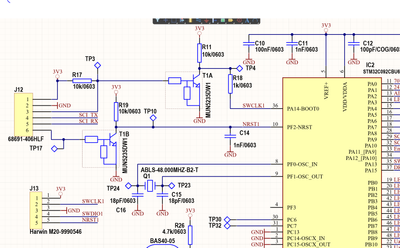

This is the board schematic:
J13 is JTAG: this is working
J12 is access to serial USART loader. RX and TX is connected to PA9/PA10.
J12 serial loader is working in case flash is empty.

Your BOOT0 pin is connected to various things. Perhaps one of these is pulling it low.
The chip itself is likely behaving as described. Option bytes seem set appropriately.

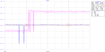

When I respect problem 1, I can always make the processor not start up the application. I remove full power. I set Boot0 Pin to high level and reset the uP with a low going impulse on nRST Pin.
Sometimes I can program the uP now, but in 90% of the cases the processor is not answering on his TX Pin (PA9)
This is the case serial download is working: blue is the character from Computer. Red is the answer from built in bootloader.

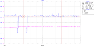

This is the case with a download fail. TX Pin (red) is always low, even with Character on RX Pin. So I think internal bootloader is not running or it is running on a wrong interface.
I'll also tried the newest STM32Programmer V2.20.0. Result same failure rate.
I replaced all my cables between STM32C092 board and USB Port of computer. There is no difference. I'm sure there is no failure of cable and electronic. As standard I use FTDI serial to USB converter. But I have same failure rate with a Prolific serial to USB converter.
