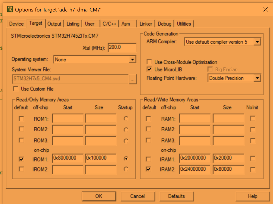

I'm trying to port some code from a Discovery F7 Board to the dual-core H745 Nucleo board and I'm going to make use of the following peripherals:
ADC, DMA, SDMMC, Ethernet and UART.
I have this all working on the Discovery board but I'm having trouble setting up the ADC with DMA using CubeMX. I'm aware you can't use DMA with DTCM RAM and I've read the following document: https://community.st.com/s/article/FAQ-DMA-is-not-working-on-STM32H7-devices
My ADC setup using CubeMX involves:

However, there's nothing to be seen in DMA. I'm using Keil and following the sugesstions in the document above,
I disabled DCache and enabled the AXI-SRAM RAM section at 0690X00000BuWLHQA3.png
This didn't work.
  • I then tried enabliing both ICache and Dcache and then invalidateDCache like this:
void HAL_ADC_ConvHalfCpltCallback(ADC_HandleTypeDef* hadc)
  /* Invalidate Data Cache to get the updated content of the SRAM on the first half of the ADC converted data buffer: 32 bytes */
  SCB_InvalidateDCache_by_Addr((uint32_t *) &ADC_DATA[0], ADC_CONVERTED_DATA_BUFFER_SIZE);

This didn;t work either. Has anyone successfully gotten this working and could you please possibly share a step by step tutorial?
1 REPLY 1
PHoll.1
I have also problems with DMA for the ADC. But I get DMA transfer error. I tried the stm example for stm32H745ZI but the examples fails with the same error. I use the latest drivers (as part of cubeMX) . I start to belief there is an error in the HAL drivers causing this. But I can be wrong. Atleast check if you don;t get an ADC error by implementing HAL_ADC_ErrorCallback and check the error message in the dma handle if it catches an error.
