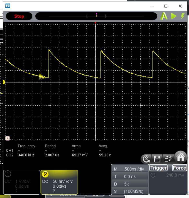

Hi, Can anybody help to point out why the pin voltage on adc input goes high as soon as i start the adc. When I connected a 10K resistor between AIN1 and GND (VDDA=VDD=3.3V), the voltage dropped to 1.6V. I tried HAL_ADC_START , Start with IT , DMA and calibration, but the voltage returns. I added 2 Sec delay for debug and verified the thing occurs when start command is given..

This is normal. You have to use low impedance signal source.

Please refer the attached wave form. Connection - 1K resistor and 0.1uF Capacitor in parallel, connected across AIN1(PA1) and GND.. It shows some sort of differentiated wave.
Ah, so it's a transient spike and the voltage tends to zero during sample and hold period. This is expected. Your sampling period (under 3us) is pretty small, so you'll need to ensure the source is sufficiently low-impedance.
Looks like a 1K resistor is okay, but 10K is not.

The problem solved with 1K res and 239 cycles... Still the transient is there but averaging with DMA overcomes it.. Thank you for your kind support
