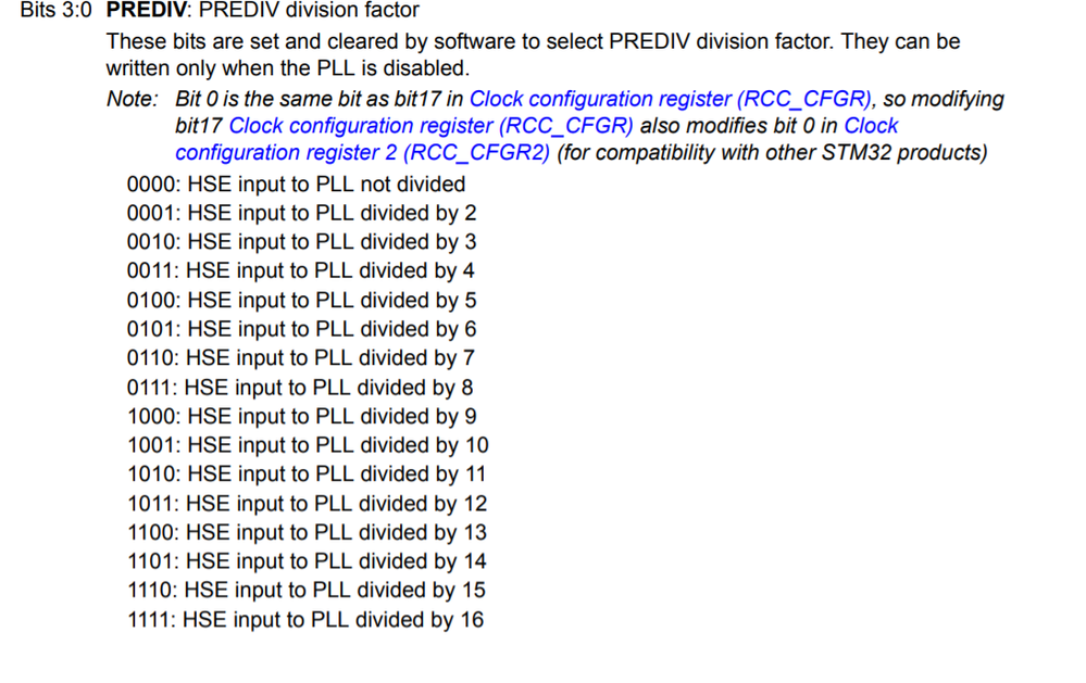

So I have trying to get the UART to work for a while and after looking at the lines with scope, I discovered the the uart is twice the Baud rate I programmed it to and I don't know why.
So I am running my uC of a 16MHz external crystal dividing that by 2 to get 8MHz at PLL input. Multiplying that by 9 to get 72MHz SYSCLK and then dividing that by 2 to get 36MHz APB!1clock which is the maximum.
After I do this I stole a function from the SDPherif Libraries to check that the clocks are indeed what I set them to and they are correct PCLK1 is 36MHz.
With the R8, the USART 2 clock source can only be PCLK1 as indicated by the datasheet and it cannot be changed.
Hence then I set my Baud rate by plugging in the following into the BRR register. 36000000/9600. However the baud rate comes out twice as fast.
So that means either:
1 - APB1 is running off 72MHz which is outside is spec
2 - The clock source for the UART2 is being used as the SYSCLK

  USART2->BRR = 36000000/9600; // 36MHz / 9600

Make sure
#define HSE_VALUE 16000000
Often in stm32f3xx_conf.h, or similar
I have chnged both that and the " options for target 1 " in keil to no avail
I did update the HSE_VALUE to reflect what I have but that did not fix it.
The mistake was in line 44 and 43. I removed the CFGR 2 line and added the following to line 44 | RCC_CFGR_PLLXTPRE_HSE_PREDIV_DIV2. That was my main issue.
I also had another little mistake in the last while loop of the RCC Init but that was not the issue.
I was setting CFGR2 as the pre div inas seen below, as it says it is the same as CFGR, however when I set CFGR1 instead and removed the statement of CFGR2 it all worked well. A bit confusing but figured it out now thanks to your help.
Edit: On second thought I had tried the PLLXTPRE thing before and it didin't work so I think it was the change in definition and putting PLLXTPRE in again together
