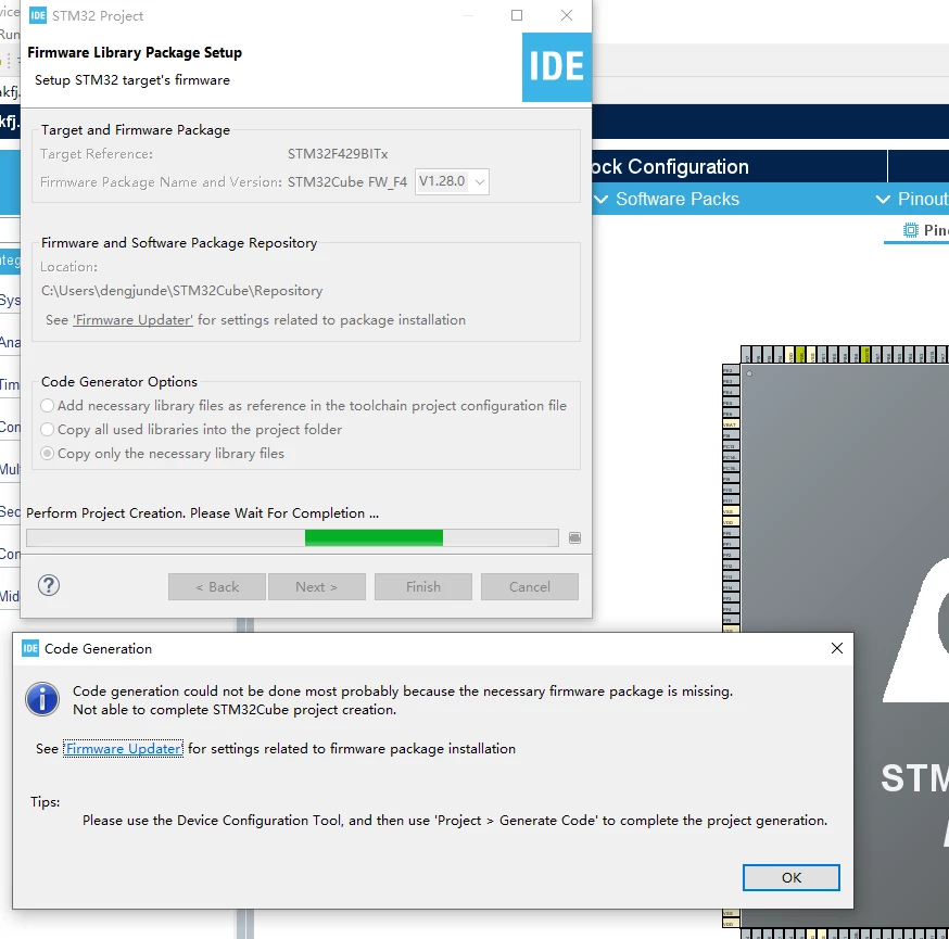

stm32cubeIDE can't create new project!
Junde
Senior III
I already installed the latest stm32cubeIDE(version 1.15.0).
when I was trying to create a new stm32 project, the error present as below:
So I want to install install software package first, but the help->manage embedded software package is no response.
what happened, I need you help, thanks!

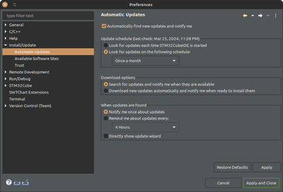

Have you tried these settings? Window->Preferences:
First time choose "Look for updates each time the tool is started". Then you might want to choose another schedule.

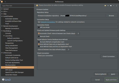

And this other too:
EDIT:
You can manually check for updates. In the main menu choose Help and then either (or both) "Check for target selector ..." and "Check for embedded ...". Both options have a blue MX icon.
Hi @XR.1
Thanks for your help!
But the above setting seems does not resolve my problem.
I tried reinstalling the lower version, but the result is the same.
But I installed the IDE on the other PC, it works well.
I have no idea what happened, and what to do next...

"I have no idea what happened, and what to do next..."
Maybe you have a proxy in the first computer.
