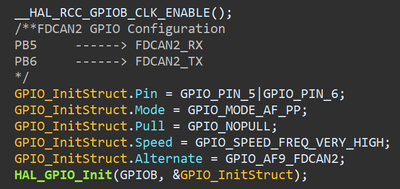

I have found an issue with code generation from .ioc file. Using STM32H7S78 DK when choosing pins for FDCAN2 (I chose pb5 and pb6), after code generation it doesnt set pb 6 as an RX. Even if you manualy add it in the code it will remove it after code generation.

Works for me. Here's the pin initialization code it generated:
You're not on the latest STM32CubeIDE version. Could be that. Could also be misreading something.

Attach your IOC file. Are you using the latest STM32CubeIDE or STM32CubeMX version?
Pins PB5 and PB6 are used by other things on the board by default.

I am using STM32CubeIde Version: 1.16.0 Build: 21983_20240628_1741 (UTC)
@TDK wrote:Pins PB5 and PB6 are used by other things on the board by default.
I have unsoldered some bricks and used them as FDCAN. I have changed their settings from default to FDCAN also
‎2024-08-20 6:34 AM
Alright, I'll update it
