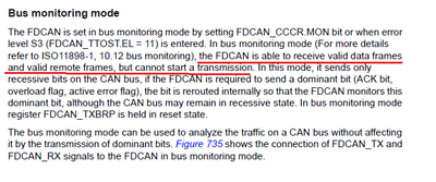

Hello @floppy and welcome to the community,
As I can see from your code, you are using Bus monitoring mode:
  hfdcan2.Init.Mode = FDCAN_MODE_BUS_MONITORING;
According to the reference manual, in this mode FDCAN cannot start a transmission.SofLit_0-1721290404372.png
So try to use Loop back mode (Internal or External)

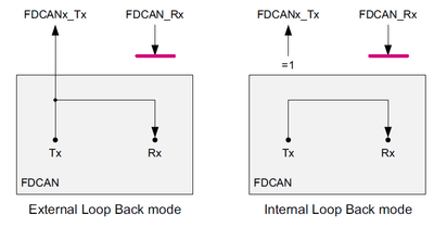

Hello floppy,
, I receive the sent blocks, but I see no behaviour on the external TX pin. I am using Pin PB12 and PB13.
You can see the sent frames on Tx pin only in External loopback mode.

You can't use Normal mode if there was no CAN  bus established and was another CAN node connected to it.
So keep external loopback mode for the moment.
As per you previous comment "In both external and internal loopback mode, I receive the sent blocks, but I see no behaviour on the external TX pin. I am using Pin PB12 and PB13."
So please attach a project with external loopback mode where you can send/receive correct data but you can't see Tx frames using an oscilloscope.
