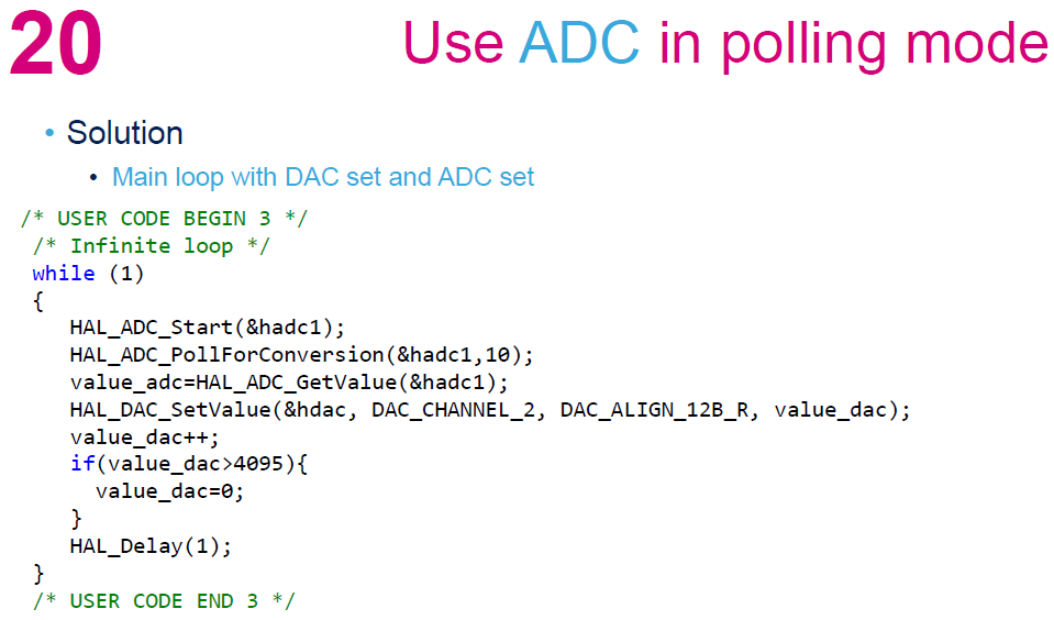

When I use HAL for ADC in polling mode I follow this approach to get reliable ADC output:

‎2018-03-19 09:35 AM
Here you can read how to use HAL driver for polling operation. This explain my example provided earlier i.e. HAL_ADC_PollForConversion
Details in stm32f4xx_hal_adc.c
*** Polling mode IO operation ***
================================= [..] Start the ADC peripheral using HAL_ADC_Start() Wait for end of conversion using HAL_ADC_PollForConversion(), at this stage user can specify the value of timeout according to his end application To read the ADC converted values, use the HAL_ADC_GetValue() function. Stop the ADC peripheral using HAL_ADC_Stop()- « Previous
