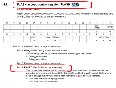

Hi, I am working on STM32C071
I wrote code to jump to ST bootloader from my application.
The code seems to work well, after jump to ST bootloader, I can connect to ST Bootloader by USB, using STM32CubeProgrammer. I can read flash data, option byte....
But if I do erase flash or change anything, STM32CubeProgrammer throws a failed message and exit STM bootloader mode.
Below is my jump function:

Below is failed message:
The error is "verify flash protection" but there is no flash protect. Because I can hold BOOT pin, hit reset pin then enter STM Bootloader again, and erase as well.

Hi, thank you for your reply,
I tried enable interrupt but still don't work.
My code is from your link actually, and it does work to jump ST bootloader. Problem is after jump to bootloader, all thing I can do just read, can't change for write to flash.
Here is an update with enable interrupt, share to me if any recommend

Hi, I just found out a supper simple way, just one line of code, I am not sure if it work on your processor but it works on mine.
Set this flag to 1, and trigger a reset,
