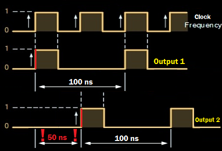

I'm just getting started with STM32, so I'll ask
I need to generate a 25ns pulse 75ns gap on one output and again
On the other the same, but shifted by 180 degrees, ie by 50ns
Is it in the power of STM32 timers to do this?
The whole is mainly the rising edges of the pulse, they must have a fixed distance.
I compare their phase shift on a phase comparator
this signal generoji with a handful of 74LVCxxx leaning on TCXO, but I would like to drastically simplify the matter
Thank you for kicking in the right direction

In newer STM32 models, timers have Combined mode, which allows to generate phase-shifted waveforms within one timer. It's simpler than using the master-slave mechanism between timers, which for cycle-precision suffers from undocumented latencies.

Seems quite doable to me using 2 timers, one slave in gated mode and one master, on any STM32 series.
Probably not something HAL supports, but if you're comfortable making your own code and reading the reference manual, it should not be too difficult.

That's why I recommend using any newer STM32 ('F3, 'L4, 'G0, 'G4, 'H7) which has the Combined mode in Timer.
