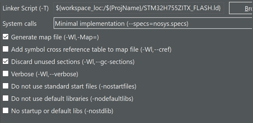

I'm not suggesting there's a big bug with GCC - but there's a problem somewhere, either with my linker or the generated project settings. Here are my linker settings (Nothing in the 'libraries' or 'misc' tabs) :
0693W00000BahZyQAJ.pngAny ideas where to look next?
I have no idea why the linker would be doing something other than executing your linker script. Could be missing something.
