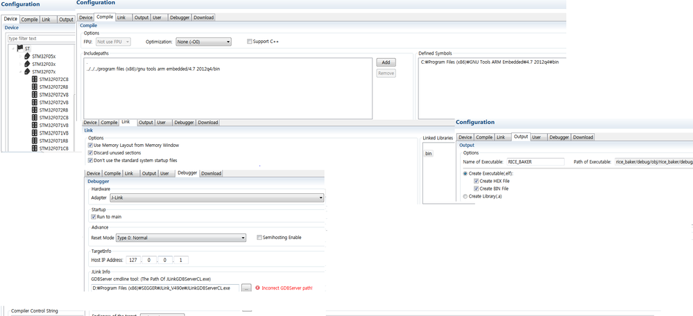

1. Does it a problem for wrong version selection for CMSIS?
2. Is it a linking problem?
3. Do you want me to change build configuration and include all HAL library ? My device package is not available in Configuration database of Coo-cox.
#coide #gnu-tools-arm-embedded #hal-libraries
Note: this post was migrated and contained many threaded conversations, some content may be missing.
Posted on December 06, 2016 at 03:59
The image is pretty much unreadable, but why have a define for the binary software path? What does that do?
The error says [cc] so it is clearly an error from the compiler, not the linker.
You are using a Cortex-M0 part, not an M3
CooCox have been out of business for a while, and their support has always been a bit sketchy.

Kindly click the image!
As I told you previous post.
ARMCC can not compile my mdk-keil (while trying migrate coocox project to mdk-keil-uvision )for different standard file.
I manage to fail in Ecilipse also.
Kindly, give me a way to carry that project.

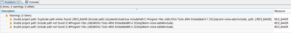

4. Did you see CMSIS errors are disappear?
At the same time the problem log shows,
Regards
Hasan
