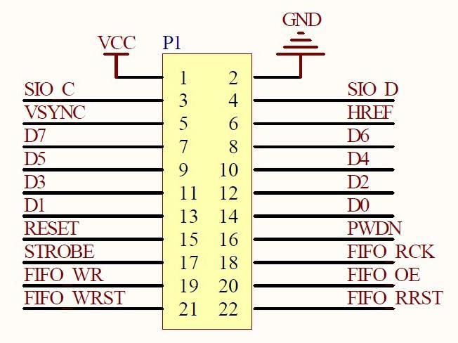

Guys,
I have OV7670 module and STM32 dev board, I'm confused on how to connect the port of STM32 and OV7670 at the module because of the name of the port on OV7670 is different with in STM32 code, anyone has experience ? thanks
Ä£¿éÒý½ÅÃû³Æ | ÃèÊö | STM32¶ËÒý½Å�?¬½Ó |
SCCB_SCL : SCCBʱÖÓ : PB10 I2C2_SCL
SCCB_SDA : SCCBÊý¾�? : PB11 I2C2_SDA
CAM_VSYNC : Ö¡�?¬²½ : PA0 �?ⲿÖ�?¶�?0
CAM_HREF : FIFO : PB7 GPIO
CAM_WEN : FIFO�?´ÔÊ�?í : PD3 GPIO
XCLK : CMOS´«¸�?Æ÷Ö÷ʱÖÓ: PA8 MCOÊä³ö
CAM_RRST : FIFO¶�?µØÖ·¸´Î» : PE0 GPIO
CAM_REN : FIFOƬѡ : PD6 GPIO
CAM_RCLK : FIFO¶�?ʱÖÓ : PE1 GPIO
FIFO D0~D7 : FIFOÊý¾�?Êä³ö : PC0~PC7 GPIO

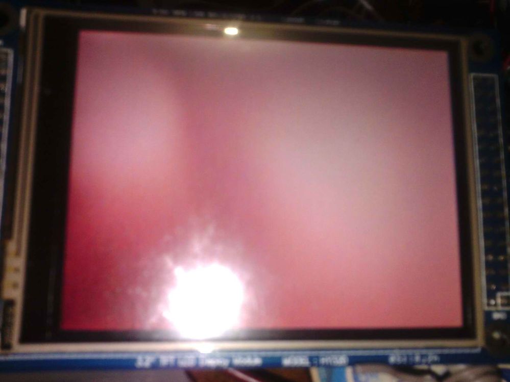

Posted on April 08, 2014 at 14:08
after I put 10K pull up, I got response, but I haven't seen a proper picture,
only dot dot red green blue cyan, but when I moved the sensor (ov7670) the LCD was moving as well....
Update,
 the display has displayed picture completely but very slow.....is it because of the 12MHz on OV7670 or I2C clock is too slow ?
Does anyone have experience ?thanks

Posted on April 08, 2014 at 15:43
It I2C is use for configuration, I don't expect you'd need to keep talking to the camera via I2C once setup.
The DCMI speed would presumably dictate how fast the data was extracted from the FIFO

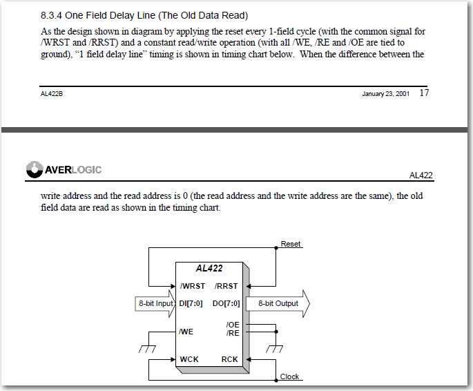

Posted on April 09, 2014 at 02:07
Understand that most of the green text you post related to the pins reads as hieroglyphics
The FIFO is rated up to 50 MHz
The OV7670 from 10 to 48 MHz
What clock is you camera generating, or what clock are you passing to it? Are you generating a clock via the MCO pin PA8? Do you have a manual or data-sheet for your camera board/module?
Posted on April 09, 2014 at 02:14
DCMI is the Digital Camera Interface on the F4 parts, it's a very high speed parallel interface. As I recall up to 50 MHz
The F1 doesn't have one, so you are either using DMA or manual GPIO toggling/reading, the latter will be rather slow.
