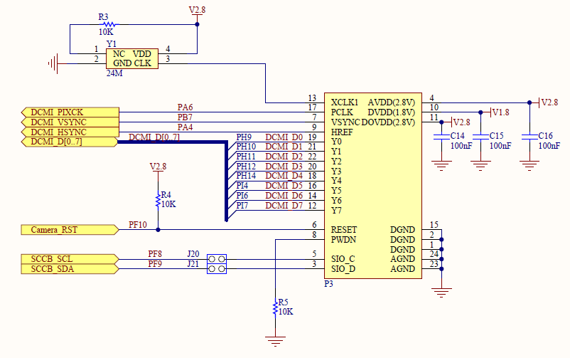

Posted on April 08, 2014 at 05:19
This is from one of the boards I've looked at supporting the OV7670

Posted on April 08, 2014 at 07:57
are the pin connections the same ?
Clearly they are not. It would help significantly if you reviewed the part documentation.
How does it work with the FIFO, I don't know, but the Camera itself is compatible with the DCMI peripheral, so the point of the FIFO is what? The purpose of having a FIFO is to mitigate the interfacing of the camera to a micro without a DCMI peripheral.
A direct connection of the
http://www.voti.nl/docs/OV7670.pdf
is consistent with the F407 schematic I provided earlier. As you're using an F10x part you'll need to make an assessment for that.
Posted on April 08, 2014 at 08:13
The purpose of the
http://www.frc.ri.cmu.edu/projects/buzzard/mve/HWSpecs-1/Documentation/AL422B_Data_Sheets.pdf
is to act as a frame grabber. You still need to generate video timing signals for the camera (clocks, horizontal, and vertical timing), and reset/initialize the FIFO, using GPIO pins. The FIFO would attach to an FSMC type external bus arrangement, allowing you to extract the frame.

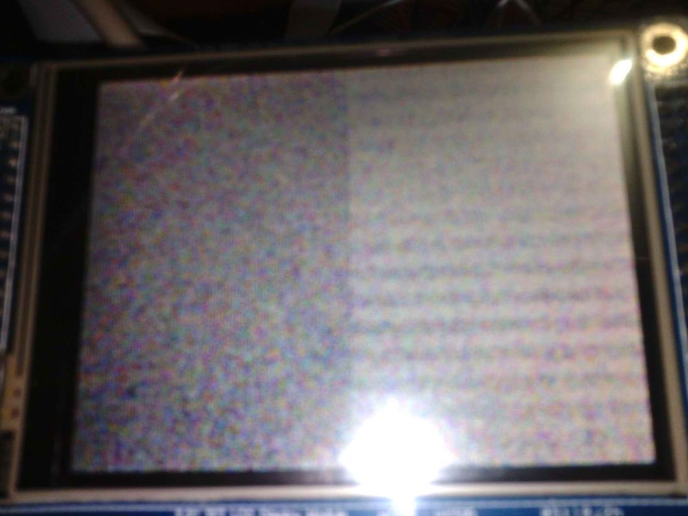

I got response from LCD but when I test the port of the Camera with LED, not even a blink....
and on USART it stops on
while( 1 != Sensor_Init() );
