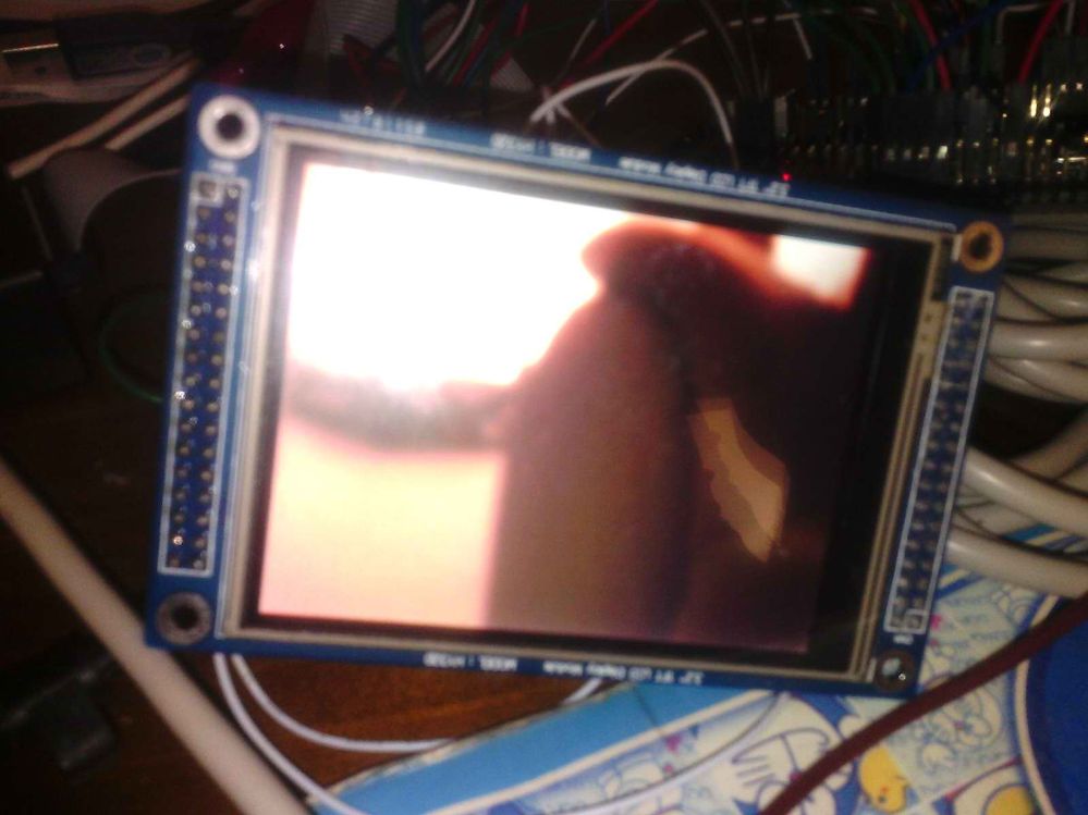

is it ok to overclock STM32F103 to 96 MHz ? I can see the picture already, I must fix the focus of the lense, but the picture changing is slow...any solutions for it ? thanks
‎2014-04-08 7:01 PM
Your bandwidth is limited by your choice of STM32 part, and the speed of the previously provided loop.
Look at the code generated for the loop, how the clock is pulled up/down, and how the LCD is written.Up vote any posts that you find helpful, it shows what's working..

Last result :
