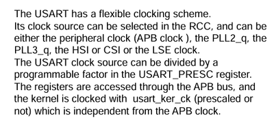

I solved the problem. I was using HSE as clock. When I looked at the UART documentation for this card, I saw that clocks such as HSI, LSE should be used instead of HSE. Indeed, when I changed the HSE, the problem disappeared and communication took place smoothly with the same baudrate on the transmitter and receiver sides. If anyone knows a way to use HSE here, please let me know.
Where did you find this information? could you please share screenshot of that? because this doesn't make sense!
You can find it in the document in ST website which name is "STM32H7-Peripheral-USART interface (USART)". Write it google you will find this document. I attached the photo of the part where I solved my own problem.
Missing HSE in the documentation doesn't mean that HSE should not be used. So how did you select HSE for the USARt if you are using CubeMx? that doesn't make sense. The USART should not select HSE for it. So in that case how did you use HSE as clock source for USART?
For example the UART examples on the  STM32H743I-EVAL board use HSE as source clock. So your issue is something else. You need to share your project.

Before the problem is solved, i chose the HSE from the clock configuration in CubeMX. After i read the documentation, i chose the HSI clock and my problem is solved. Uart receiver and transmitter is working fine now. I dont change anything except this.
