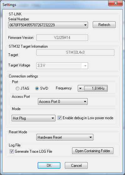

Before the update, connecting to the target and programming the .srec file used to take only a matter of a few seconds.
Now, with the new one, it took almost 1 hour until it finally released the connection and the device memory is displayed (it took further 20 minutes after the 'Verification... OK ' message appeared on the screen (please see below), until the GUI fubakkt became responsive).
Below is the log - please can you tell us what is causing this problem, or could we have the old version of the firmware back?
13:35:05 : ST-LINK SN : 55FF79064986565716411287
13:35:05 : ST-LINK Firmware version : V2J23S4
13:35:05 : Connected via SWD.
13:35:05 : SWD Frequency = 005 KHz.
13:35:05 : Connection mode : Connect Under Reset.
13:35:05 : Debug in Low Power mode enabled.
13:35:06 : Device ID:0x414
13:35:06 : Device flash Size : 512KBytes
13:35:06 : Device family :STM32F10xx High-density
13:36:13 : [testboard debug console 13-04-2018.srec] opened successfully.
14:02:16 : Flash memory programmed in 25mn and 50s and 868ms.
14:02:16 : Verification...OK

I've posted mirrors to older versions of the ST-LINK Utilities, and firmware updaters in the past, there is no difficulty downgrading the firmware. I would avoid J24 and J25 as these have issues with holding devices in reset when attached to USB chargers or battery packs.

SWD frequency is set to 5kHz, which is veeery slow.
Try increasing it to something like 1.8MHz in 'Target/Settings' :
