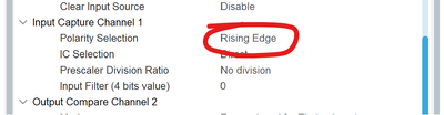

A little hard to decipher the behavior you want here. Perhaps a diagram would help.
You want CH2 to go high a set period of time after CH1 goes high? And then an indeterminate amount of time later, you want CH2 to go low after the same period of time as before after CH1 goes low?
IC polarity is selectable in CubeMX.

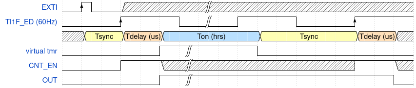

Yes, it's hard to explain, so I found a diagram tool and came up with this:
  • The external int starts the sequence, but I am using the slave trigger mode to synchronize the actual start of the timer with the edge at TI1F_ED. This is Tsync which is variable
  • Then output compare at CH2 sets the OUT active. This gives the fixed Tdelay in us
  • Due to the large difference in time, I'm just implementing a virtual timer in memory to handle setting the output to inactive
  • This is where I need to re-trigger the timer so it only starts once the edge is detected at TI1F_ED and the Tsync, Tdelay sub-sequence can be restarted
  • Right now, it simply runs for Tdelay without waiting for re-synchronization with the TI1F_ED
  • the CNT_EN represents how the timer enable is set. Obviously this is just an implementation detail that could be changed
On the other issue, since I'm not using input compare, just slave mode with trigger, there is no control over the edge polarity in cube mx, at least that I could find. I'm not sure if there would be a better configuration for this process, as I've mostly use timers for very simple delays, etc.

The TI1FP1 edge detection works perfectly, even provides a little noise immunity too. CubeMX doesn't allow input compare on CH1 as it is locked out in trigger mode.
