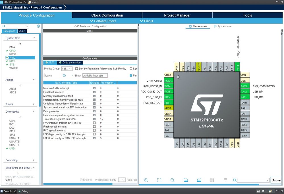

Is it possible that there's another IRQ responsible for maintaining connection, but because it's an IRQ, it causes STM32 to wake up immediately even though you don't send anything over terminal app?
.ioc:
