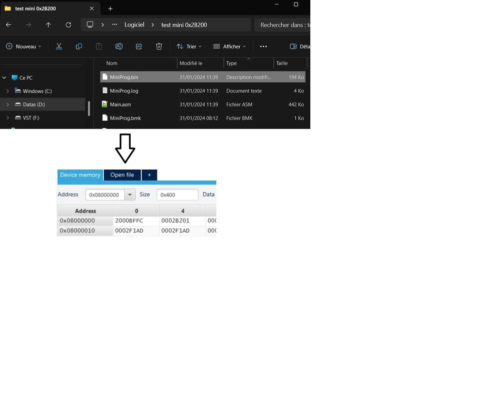

Sorry. Here the question :
I made a testing soft who start at 0x2B200
I notice than bin file has the (org address+1) at 0x04
That's OK and I used it for controlling file.

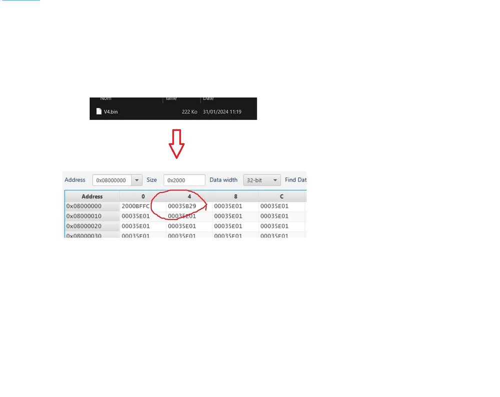

But when the file increase in size I noticed value at 0x4 was now 0x35B29   !
What can I do for this ?
"Small"  one
Bigger one, at the same adress
And big soft has about 50ko lenght (at always start at 0x2B200)
Why do you want to do something about it? What problem is it presenting?
That is the location of Reset_Handler within the binary.
With the value of bin file at 0x4 , how do you calculate address to jum to ?
Sorry for my keyboard.
I try again.
If my soft has a low size, I can calculate jump address will be (value at 0x4)-1
But if the soft is bigger, how do you calculate jump adress using 0x4 value ?
Guru
I don't understand why the value matters. The calculation is the same. (value at 0x04 - 1).
0x35B29-1=0x35B28, not 0x2B200
