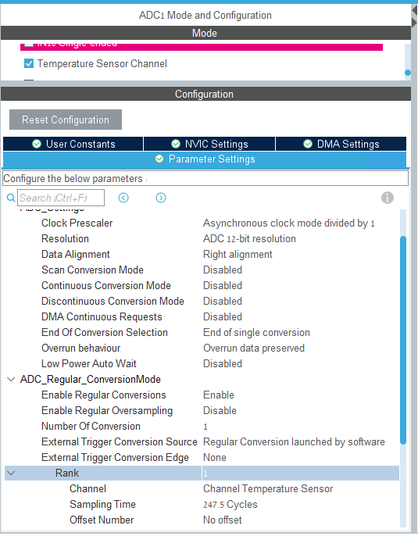

I’m trying to read internal temperature sensor on ADC1, but the ADC result is always 4095.
I use STM32L471, and I know that the problem is not HW related, when I run a different bin it reads the temp ok.
Tried to read VREFINT, raw value is also 4095.

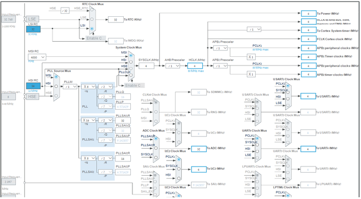

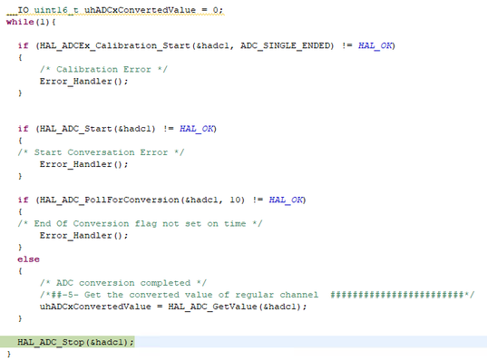

Attached below screenshots with clock tree configuration and code.
Screenshot 2026-01-20 152910.pngScreenshot 2026-01-20 153102.pngScreenshot 2026-01-20 155308.png
p.s. also tested with different clock speeds and sample cycles with no luck.
If you don't have any external voltage reference connected to VREF+, the only way to measure ADC values is to provide voltage to VREF+ internally, and that's what VREFBUF is for.
Read the ADC and VREFBUF chapter in RM, and review the VREF+ connections described in Datasheet.

waclawek.jan
What is "different bin"?
How is VREF+ pin connected?
All data presented is consistent with VREF+ not supplied or configured properly.

The vref+ pin is connected to 2 capacitors 1uf, 0.1uf in parallel, than to AGND.
I think that the missing part was to enable the internal voltage reference buffer (via HAL_SYSCFG_EnableVREFBUF)
Once I configured and enabled  it I started reading values that made sense.
Although I'm unsure if it is the correct way to measure ADC values.
