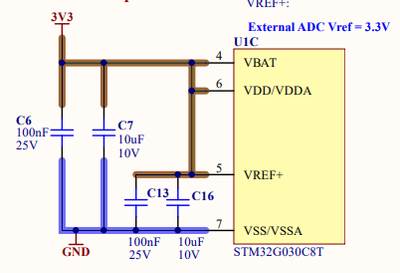

How is VREF+ connected?
KoSt
The Vref+
Regarding the readings a healthy ADC reading at 10-bit resolution should read something like 914 raw value which will correspond to 3652mV for the battery voltage, as opposed to the lower reading which will be something like 837 raw value which corresponds to 3346mV for the battery voltage.

Common denominator of many ADC-related problems is too high signal impedance/too short sampling period, crosstalk/interference (often related to improper grounding/return arrangement), unstable reference.

2) We have measured the 3V3 reference voltage and check for noise in the oscilloscope

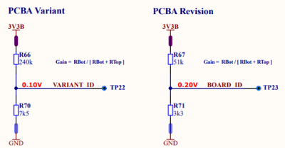

4) Regarding the impendence, again I am not very familiar on how to measure or adjust this, but I suppose in the circuit I posted with fixed resistor values it should be straight forward to work it out right? Are other parts of the circuit affecting this impedance value?
waclawek.jan
You've said that the problem is with battery voltage measurement, yet you're showing schematics for measurement on a divider not related to battery.
