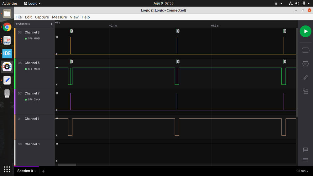

Initialize the CS pin as a GPIO output and manipulate it manually. Set it low before HAL_SPI_TransmitReceive and high afterwards. Don't use the "hardware NSS" mode.
Edit: This is for the master. On the slave, do use the hardware NSS pin.

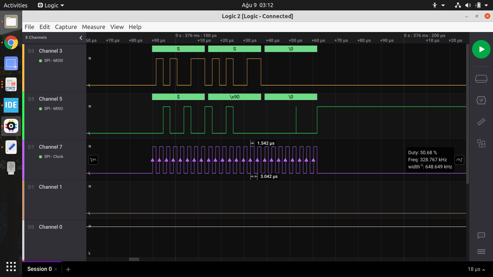

Zoom out view of logic analyzer. channel 1 is slave select pin that is configured manually as GPIO output not hardware NSS for master side. I configured hardware NSS input from cubemx for slave side0693W00000D1qidQAB.png

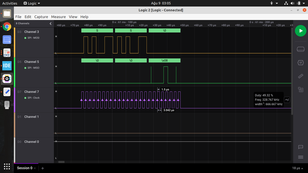

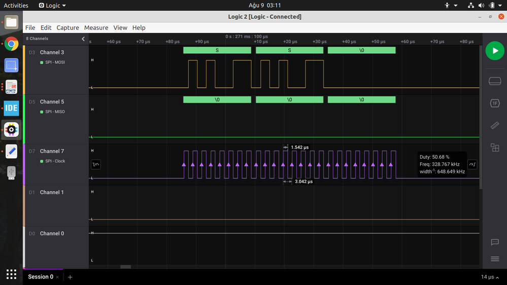

Zoom in views of some transmission and reception datas. I used just "SS"(actually 'S','S','\0') string from master to slave and slave to master. Thus 3 datas will be seen every transmission and reception. MOSI datas are good and MISO datas were changed every time. I showed below pictures.
0693W00000D1qk5QAB.png0693W00000D1qkeQAB.png0693W00000D1qlIQAR.png0693W00000D1qkoQAB.png

>You still did not tell us, why do you think your SPI communication is failing. What exactly are the symptoms and how are they different from the expectations?
There must be same data on MOSI and MISO line because I send same string from slave to master and master to slave. Thus MISO line or from slave side cannot respond properly. Also, I am using polling mode to try SPI communication. I made slave select pin manually from gpio output but result is same.
