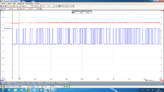

In order to do it, I first try with my evaluation board, which I've solded three wires in the pads 20(tx), 21(rx) and 28(gnd) which I've connected to a bord with UB232 module USB. I've connected pin 20 from STM32 to pin 8 of UB232R, pin 21 from STM32 to pin 7 of UB232R, and pin 28 from STM32 (gnd) to pin 1 of UB232R.
I check my signals into oscilloscope, and I see a continue 1.82v and 1.59v in each channel. I don't know why, because I think I should see 0's or 1's. What is it happen?

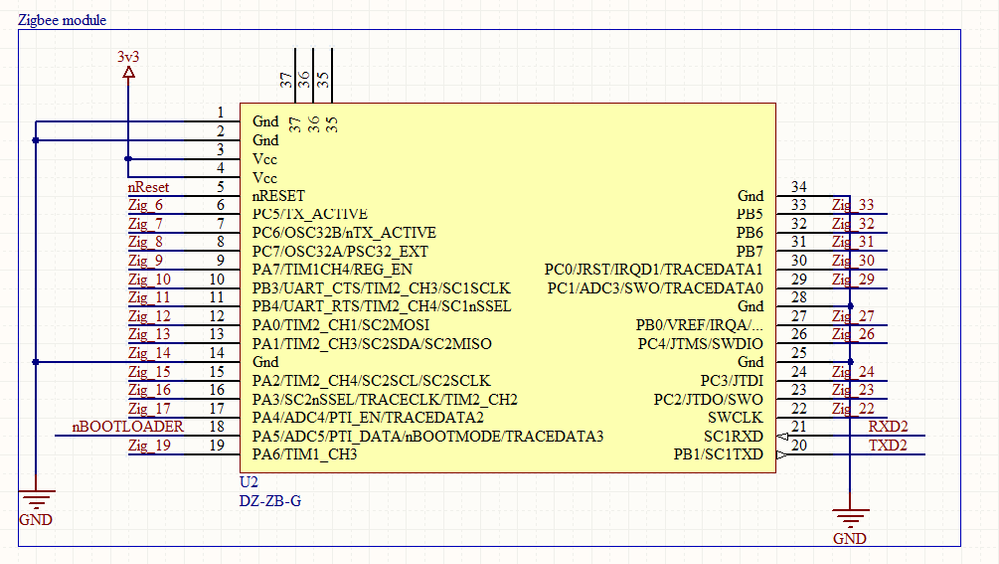

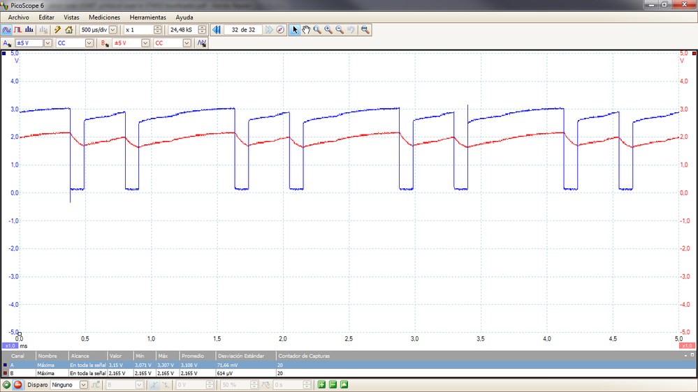

Well, I only program my dsPIC with two uarts (in order to control some bits through Tera Term/hyperterminal/Real term program), a pin connnected to nBOOTLOADER(pin18 of STM32W) and a pic connected to nRESET (pin5 of STM32W) and a led.
If I sent all the time the char ''127'' (0x07), I can see through oscillscope the Tx and Rx signals and I don't understand the RX behaviour:

Posted on March 11, 2013 at 13:31
I've done some progresses, my first error is do not supply my zigbee module, the person who advice me, told me  is it not necessary.
Ok, I reset my dsPIC and I detected (with oscilloscope) the following frame from STM32W108, but I don't know what them mean.
1st: 000001001 --> start bit + 00000100 + stop bit (1) = 0x04
2nd: 0x04
3th: 0x04
4th: 0x04;
5th: 0x58
6th: 0x50
7th: 0x04
etc...
Where I can find what each command mean?
Why the frecuency is 11.49KHz?
Thanks

I've found out my problem, and I've achieved to connect that I wanted. Hardware connections: 0690X000006054RQAQ.png And the C software part:
