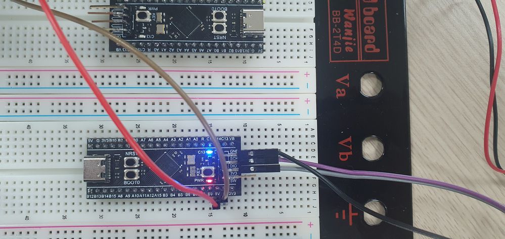

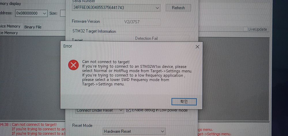

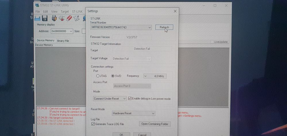

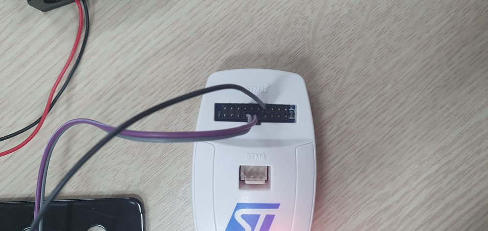

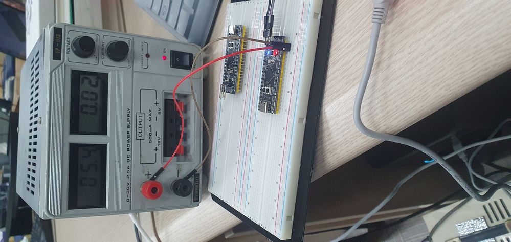

I will attach the image of my cell phone using two different computers. Please understand.

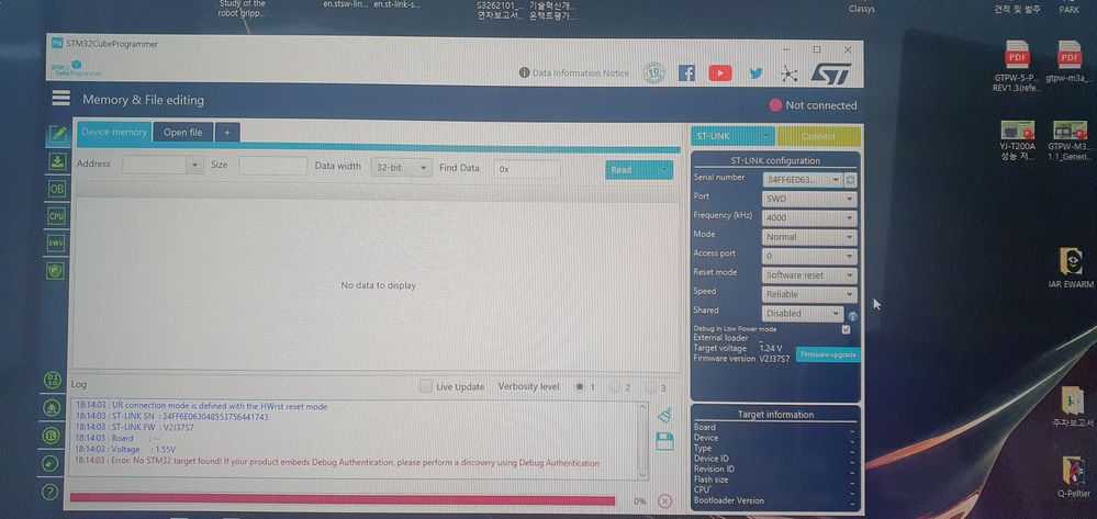

I don't know if you can see it well in the picture, but I'm connecting with ST-LINK/V2 using STM32F401CCU6 board by referring to other YouTuber videos and using "ST-LINK Utility" SW. Yesterday, when I connected with a fake product, it went well, and now I replaced it with a genuine product and ran it, but I can't read the STM32 (Target) although the USB Connection Error doesn't come out. Do you understand me?
Try with CubeProg. This utility is deprecated. If it doesnt work, change this horible wires and recheck if they are on the right pins. And, are you sure, it si the true STM32 product?.
I think they say they can't find STM32 because the target voltage is 1.24V, should we replace the MCU?
I think you should wire the 3v3 of the MCU to the 3v3 of the ST-LINK. If the problem persist,Try another MCU.
Best regards.
II
Do you have connected pin for MCU voltage sense? I see only 3 wires on the photograph. If MCU works according to last flashed program, is probably OK.
