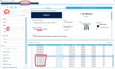

Guru
Use the Example Selector in CubeMX to generate a PWM example project.
