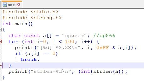

Maybe both source and target charsets for gcc should be specified:
gcc -finput-charset=CP866 -fexec-charset=CP866
Depends on the default with which gcc was built.
I tried also to pretend that both charsets are UTF-8 (though source is CP866) ; it seems to work.
 gcc -finput-charset=utf-8 -fexec-charset=utf-8
0693W000007BZFzQAO.jpgOutput:
$ gcc -finput-charset=UTF-8 -fexec-charset=utf-8 ***.c
$ ./a.out
[0] AF
[1] E0
[2] A8
[3] A2
[4] A5
[5] E2
[6] 00
strlen=6
 As you see the string is correctly encoded in 866, each char one byte.
-- pa
