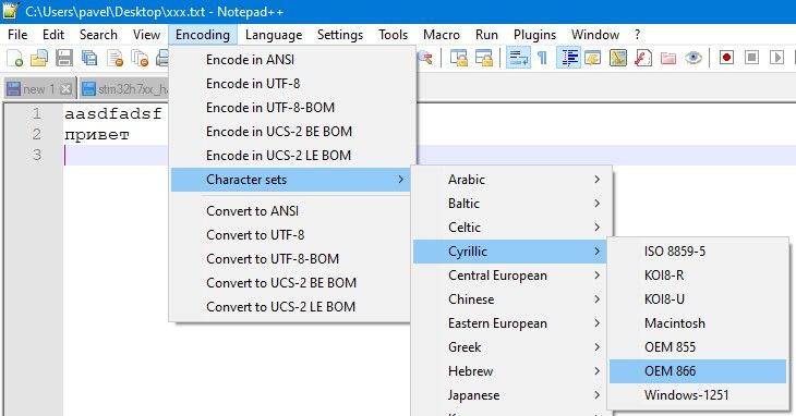

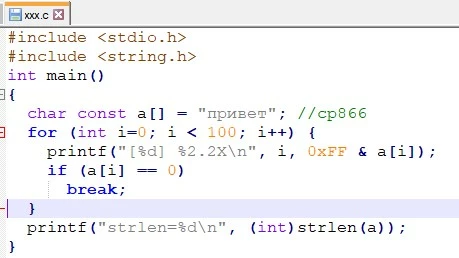

    Pavel A.
    January 17, 2021
    Pavel A.
    January 17, 2021
    Maybe both source and target charsets for gcc should be specified:
    gcc -finput-charset=CP866 -fexec-charset=CP866
    Depends on the default with which gcc was built.
    I tried also to pretend that both charsets are UTF-8 (though source is CP866) ; it seems to work.
     gcc -finput-charset=utf-8 -fexec-charset=utf-8
    0693W000007BZFzQAO.jpgOutput:
    $ gcc -finput-charset=UTF-8 -fexec-charset=utf-8 ***.c
    $ ./a.out
    [0] AF
    [1] E0
    [2] A8
    [3] A2
    [4] A5
    [5] E2
    [6] 00
    strlen=6
     As you see the string is correctly encoded in 866, each char one byte.
    -- pa
