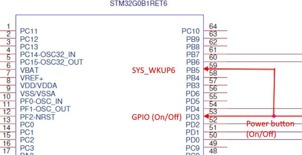

I am looking for a software solution for this race condition:
* The power button is connected to both the On/Off pin PD3 and the wakeup pin PB5. See the partial schematic.
* The issue is that the STM32G0 enters shutdown mode, but immediately wakes up. Please see my function below.
What is missing? Thank you!

What is missing is disabling systick. Could be other things.
Saket_Om
Hello @Kmax18
In addition to @TDK recommandation, you should:
  1. Clear all relevant WUF flags (not just WUF6) before enabling the wakeup line.
  2. Also clear the Standby/Shutdown flag if it’s set.
/* Enable PWR clock */
__HAL_RCC_PWR_CLK_ENABLE();
/* Clear all wakeup flags and shutdown/standby flags */
__HAL_PWR_CLEAR_FLAG(PWR_FLAG_WUF1 | PWR_FLAG_WUF2 | PWR_FLAG_WUF3 |
                     PWR_FLAG_WUF4 | PWR_FLAG_WUF5 | PWR_FLAG_WUF6 |
                     PWR_FLAG_SB);
