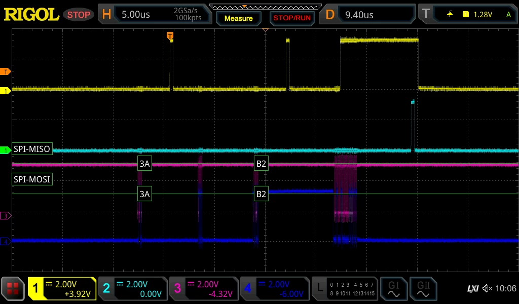

I'm having trouble understanding how the transfer complete interrupt is working.
I have setup SPI using DMA to speed up data transfer to an LCD-display.
The SPI clock is 18MHz, the System clock is 72MHz.

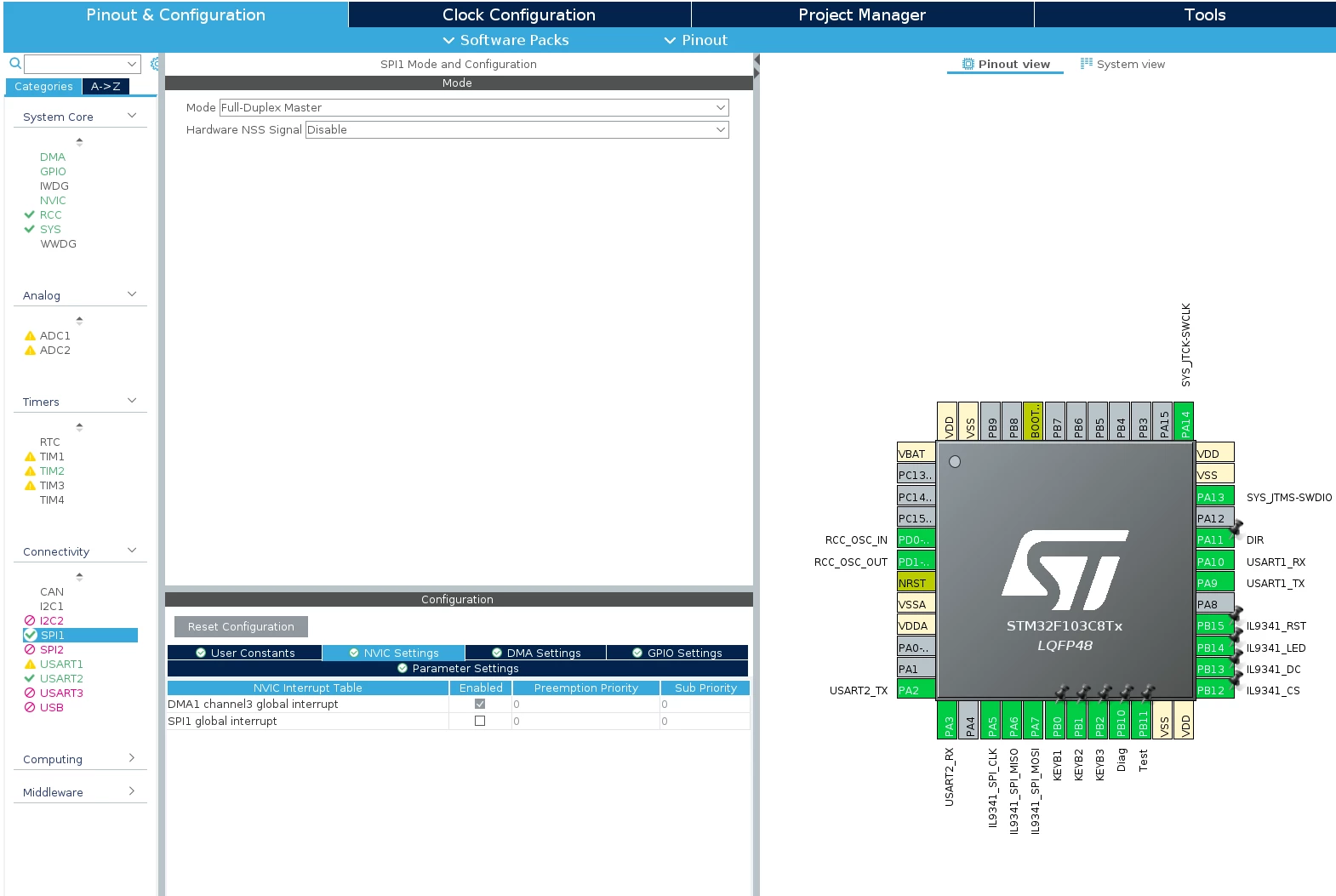

From the book Mastering STM32 my understanding is that the SPI_TX_COMPLETE_CB should be used to signal the completion.
It is also mentioned that the call back for the SPI is taken care of in the DMA Interrupt.
So I have only enabled DMA Interrupts and no SPI Interrupts.
I have copied large parts of the software and they seem to be using DMA in polling mode.
0693W00000aH56WQAS.png0693W00000aH56lQAC.pngmagenta trace is SPI-CLK
dark blue trace is MOSI/MISO
Here is the main part of the code I am using to produce the scope screendumps:
static void IL9341_WriteData(uint8_t *buff, size_t buff_size)
 IL9341_Select();
 IL9341_DC_Set();
 flag=0;
 HAL_SPI_Transmit_DMA(&IL9341_SPI_PORT, buff, buff_size);
 // while (IL9341_SPI_PORT.hdmatx->State != HAL_DMA_STATE_READY) <== this does not work
 IL9341_UnSelect();
void IL9341_Init(void)
 memset(disp_buf, 0, sizeof(disp_buf)); // fast way to fill buffer with 0
// HAL_Delay(25);
 IL9341_RST_Clr();
// HAL_Delay(25);
 IL9341_RST_Set();
// HAL_Delay(50);
 IL9341_WriteCommand(IL9341_COLMOD); // Set color mode
 HAL_GPIO_TogglePin(Test_GPIO_Port, Test_Pin); // Test pin is yellow trace
 IL9341_WriteSmallData(IL9341_COLOR_MODE_16bit);
 IL9341_WriteCommand(0xB2); // Porch control
 uint8_t data[] = {0x0C, 0x0C, 0x00, 0x33, 0x33};
 IL9341_WriteData(data, sizeof(data));
void spi_tx_complete() {
 HAL_GPIO_TogglePin(Diag_GPIO_Port, Diag_Pin); // Test pin is light blue trace
 flag=1;
int main(void)
 if((HAL_SPI_RegisterCallback(&hspi1,HAL_SPI_TX_COMPLETE_CB_ID,spi_tx_complete)==HAL_ERROR)) {
	 Error_Handler();
while (1)
	 IL9341_Init();
Using the CubeIDE, I have looked at the code in
Drivers/STM32F1xx_HAL_Driver/Src/stm32f1xx_hal_spi.c
and
Drivers/STM32F1xx_HAL_Driver/Src/stm32f1xx_hal_dma.c
My remaining Questions are:
1) is it correct to register the SPI callback or should I register DMA callback instead?
2) why is there such a long delay in the yellow trace after the DMA-transfer?
  It seems that something is stuck in low level (interrupt?) routines
  as the end of the yellow trace coincides with the transfer-complete signal (light blue trace)
  The delay seems to be similar to the delay between "normal" (non-dma) SPI transactions.
  There is no checking with a while(flag==0){;} of the "complete" flag in the IL9341_WriteData routine,
  yet it returns after completion. Does this not contradict the use of interrupts? Or is the system just slow?

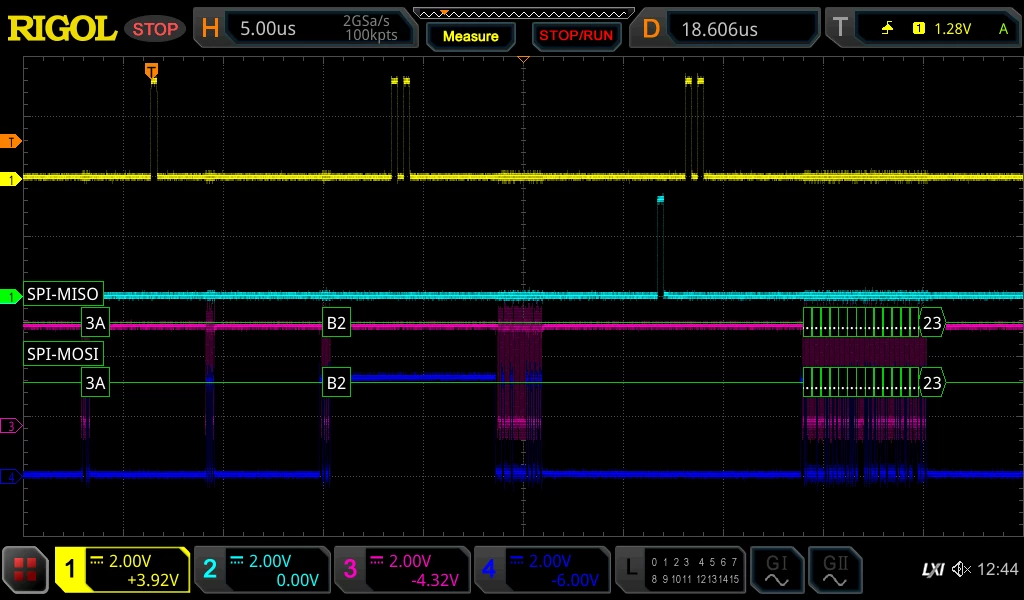

Something very strange going on. I have done some more testing and added the check for transfer complete
 IL9341_Select();
 IL9341_DC_Set();
 flag=0;
 while(flag==0){}
 IL9341_UnSelect();
for clarity I inseted double pulses before and after the transfer:
and now I get this picture:
0693W00000aH5NwQAK.pngSo now it works as expected, albeit a little slow - for the 2.25µs data burst it takes 13.75µs to signal completion.

Is it a genuine STM32, or a clone on a BluePill?
Cube is open source, so you can look up what does it do.
In the first case, probably the Tx DMA transfer finished somewhere between the first and second toggle; the Tx DMA Transfer Complete interrupt is fired, inside it probably waits until SPI BUSY ends, I wouldn't be surprised if it does so in a loop - I can't explain why the delay is so long, but honestly I am completely uninterested to wade through Cube's bloatware to do so, especially for the ancient 'F1, and especially if it's not even an STM32. Please do so yourself if you are interested. Toggle a pin at interesting points in the Cube code, for example, and observe.
IMO the most reasonable thing to do is to dump Cube and instead, write your own code. It may take some time and some effort, but it pays off in the long term. Using genuine chips with real documentation often pays off, too.
And use Rx to determine end of SPI transfer.
