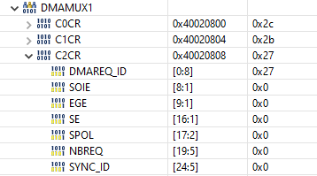

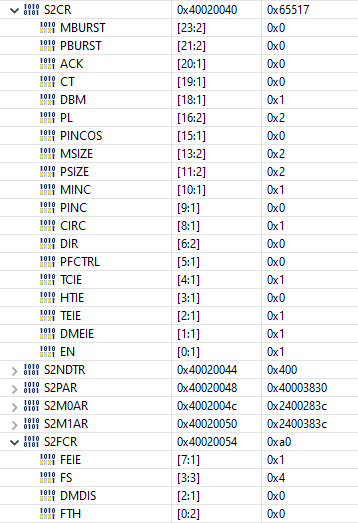

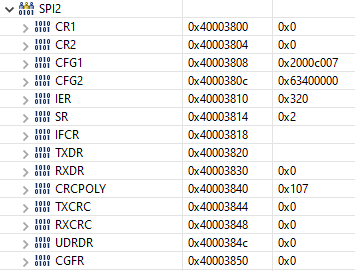

Values of SPI2, DMAMUX1 (stream2) and DMA1 (stream2) attached. These are taken just before the __HAL_SPI_ENABLE(hspi) line. As soon as I step over that the Rx DMA starts writing data to memory even though there is no SPI clock active. I can't see anything obviously wrong in the register settings. The DMAMUX request id is set to 0x27 (39) which is spi2_rx_dma.

I don't use the 'H7. Are you sure it's a good idea to set in SPI DSIZE to 8-bit, FTHLV to 1-data, yet DMA PSIZE to word?
NPato
I have the same settings in the tx direction and it works. But that's no guarantee it's a good idea for Rx, the HAL allows it and has code to handle the DSIZE/PSIZE differences. The documentation for FTHLV indicates it is more efficient to use higher values if accessing the data register as 16 or 32 bits but does not say it won't work at '1-data' setting. Setting it to '4-data' does seem to make any difference any way.
