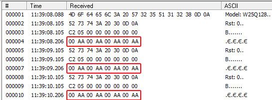

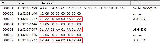

So, when I don't use DMA, I recieve proper new data for each iteration:
When I'm using DMA, I'm receiving proper data for first iteration, and data either stay the same for next iterations, or, after some iterations became 0xFF or 0x00 (but, when debugging, breakpoint in callback is triggered on each iteration).

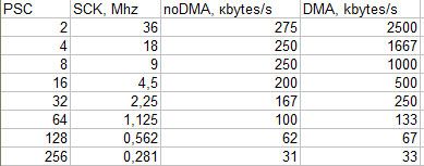

DMA is enabled both for SPI send and SPI receive, for both autoincrement is memory, data size is byte, bufer type is normal. Could I change this behavior for DMA receiving? Or could I up speed somehow without DMA? My results is:
