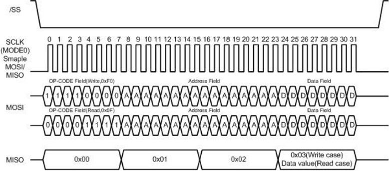

Posted on December 25, 2013 at 14:56
thank you for your response, I have done it by a DUMMY read.
in datasheet said that after sending address, the value of that comes on SPI, and I send a 0x00 byte too read the Value, but its value of previous address I sent in previous session!
_behn4m
Posted on December 25, 2013 at 15:51
thank you a lot for you'r attention
that's what exacly happening: I write on 4 addresses, and then I want too read them to make sure that I'm doing right. I read 4 addresses with read function, but at every SPI session, my received data is value of previous session address!
In data sheet said do what I'm doing with my read and write functions! here is the SPI signallimg diagram in datasheet:0690X00000602kaQAA.jpg

lowpowermcu
Posted on December 25, 2013 at 19:30
Hi Beh,
Can you give us the value of status register ''SPI_SR'' when you exit
W5100_read()
I am suspecting an overrun condition...
_behn4m
Posted on December 25, 2013 at 20:02
it is 0x43!
lowpowermcu
Posted on December 25, 2013 at 20:17
Hi Beh,
As you are using SPI in Full Duplex you must read data every times you write in data register (even if you do not need it). The writing sequence should be something like the code below:
  /*!< Wait until the transmit buffer is empty */
  while(SPI_I2S_GetFlagStatus(SPIx, SPI_I2S_FLAG_TXE) == RESET);
  /*!< Send the byte */
  SPI_I2S_SendData(SPIx, Data);
  /*!< Wait to receive a byte*/
  while(SPI_I2S_GetFlagStatus(SD_SPI, SPI_I2S_FLAG_RXNE) == RESET);
  readata =  (uint8_t)SPI_I2S_ReceiveData(SD_SPI);
Consequently, you code will be:
