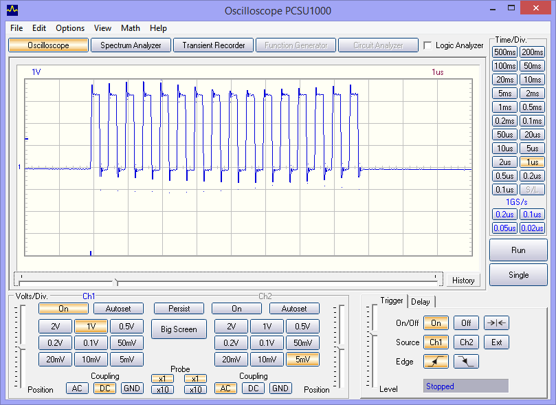

So I'm having a peculiar problem with the SPI on the STM32F072.
I'm trying to configure SPI1 and it seems to work, but with one cave-eat. I can't seem to configure the bit size (SCLK) down to 8b from 16b. I've been trying to do it through the CMSIS initialization structure but the changes aren't having any effect, so I've also tried it directly in the configuration registers. Still no luck.
The part where I tried configuring the registers manually:
SPI1->CR2 &= ~(1<<11);
SPI1->CR2 |= 0x700;
SPI1->I2SCFGR &= ~(1<<10);
SPI1->I2SCFGR &= ~(1<<11);
As you can see I've also thought about having the SPI configured in the I2S mode, but this doesn't seem to be the case.
The inserted picture is the oscillograph of the SPI Clock line (single transfer). No matter what I do, it clocks 16 bits.
The initialization routine is below:

Posted on June 22, 2015 at 23:06
And what are the content of CR2 and I2SCFGR before you enable the SPI peripheral?

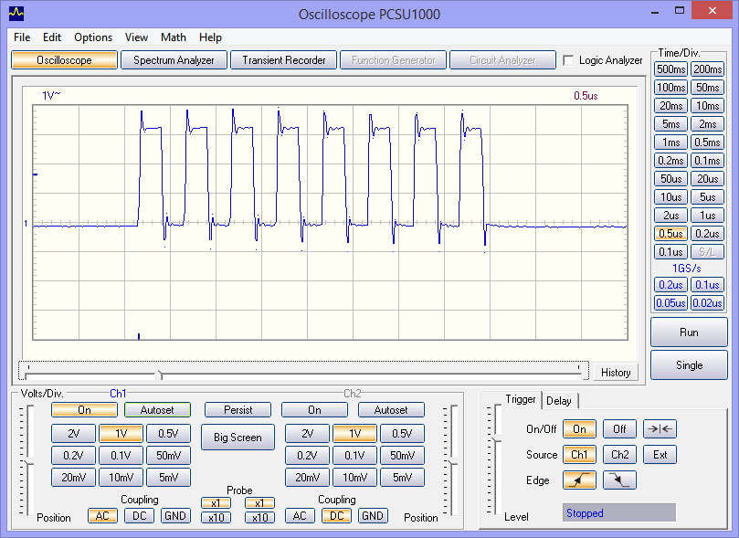

So just for kicks, I initialized the structure with
SPI_InitStructure.SPI_DataSize = SPI_DataSize_4b;
And this is the result (SPI clock)
The value of the CR2 register is properly initialized for the 4-bit transfer, but from the oscillograph, we can see that there are 8 clock cycles there.
Now I'm really interested in what exactly is happening. Did I completely misunderstood SPI, or is there something fishy going on?
