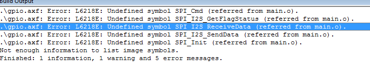

im trying to use spi cmsis function in
STM32F10x Standard Peripherals Library V3.4
when i use examples of its own folder my compiler keil5.11a (with stm periph lib v3.5) shows this error:
and i know these functions are defined in cmsis lib
whats reason of error?
can it sources from deferrences between keil cmsis & my downloaded version (v3.4 ) ?

This is a linker error because your project doesn't include the stm32f10x_spi.c file, add it.
STM32F10x_StdPeriph_Lib_V3.5.0\Libraries\STM32F10x_StdPeriph_Driver\src\stm32f10x_spi.c
