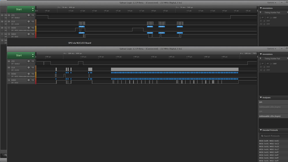

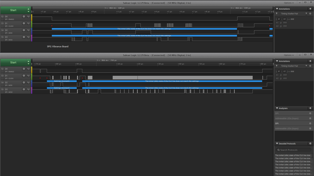

I'm trying to read an EEPROM connected to SPI1 and facing difficulties. For some reason the clock is off by being idle high. This doesn't happen if I use SPI3 and am therefore wondering if there's some characteristic or further configuration that is required with SPI1?
Note that I'm using PA4 for both scenarios but this is a manual process anyway; send PA4 low, interact with SPI, send PA4 high. However, I cannot see this being an issue. I've attached a couple of images showing the results as follows:
SPI1 (bad):
SPI3 (good):

I do seem to be getting a clock ok, just that it seems to be idle high. Everything is configured using CubeMX and the CubeIDE to configure the peripheral and generate the code. Other than changing the GPIO pins, everything is the same between SPI1 and SPI3, except it works no problem with SPI3. It seems that SPI1-3 can also​ function as I2S and therefore I was wondering is there was any other possible functionality that could be interfering and causing this anomaly?
I wouldn't call that ok.

Thanks again for responding and sorry I've not updated sooner. Yes, I checked but more importantly I found that the connection was a little dirty; a quick clean and everything appears to be working fine now.
