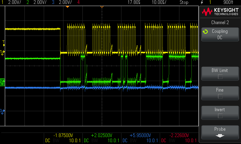

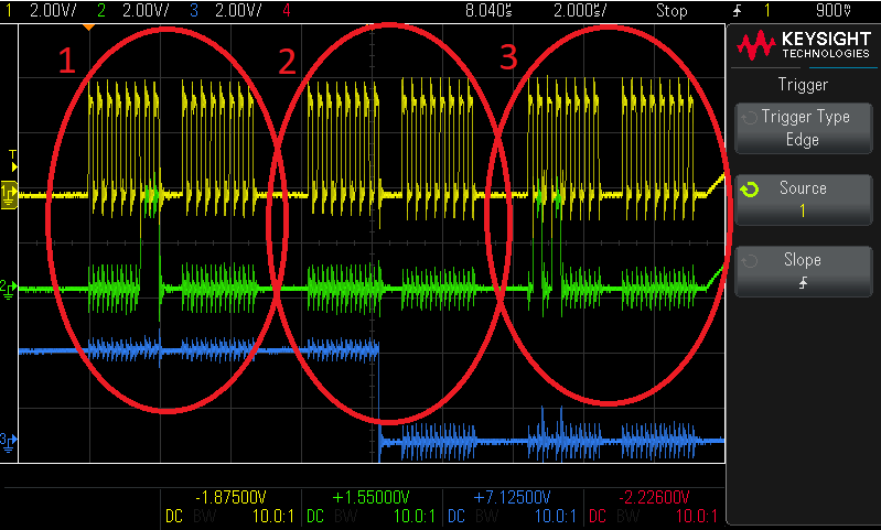

I'm facing an issue after configuring the SPI1 of STM32G491REI6 MCU using STm32CubeMX for SPI_DATASIZE_8BIT. I have captured the signals on the Oscilloscope after Transmitting the followed three-byte (0x03, 0x00, 0x50) from master(MCU) to slave. you can see clearly in the image for each byte transmit MCU is generating a clock two times, which is undesired. Clock (Yellow) and data(Green)
For SPI_DATASIZE_9BIT is working fine, see the second photo.

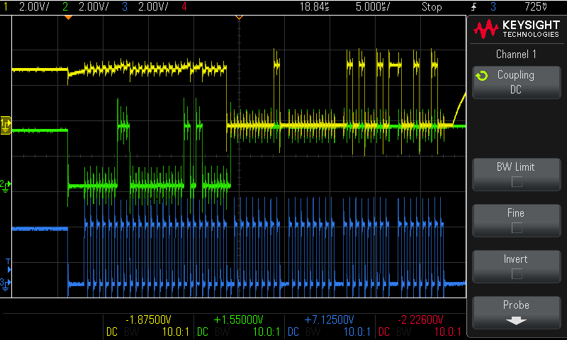

I have tested the same code SPI_DATASIZE_8BIT for the STM32F446RE MCU and that's working fine, See Photo.
The only issue is with STM32G491REI6 using SPI_DATASIZE_8BIT. Please provide the scalable solution as per the mentioned query.

Show the code you're using to write the data to the SPI.
Possibly you're using a 16-bit instruction, so sending two bytes instead of one. The G4 has a FIFO here whereas the F4 does not.

It's probably not FIFO but data packing.

I am placing two type code snippet I tried-
In main routine, NSS is Reset forcefully by firmware (GPIO control), after that "SPI_Transmit" function is called.
when you set debugger breakpoint at line4 or line3 of functions, still 2 Bytes sent by the controller (Image attached)

> SPI1->DR = data;
If you want to write a byte (as opposed to a word), you need to force the compiler to use a byte access instruction.
*((volatile uint8_t *) &SPI1->DR) = data
https://github.com/STMicroelectronics/STM32CubeG4/blob/e762fe2ce800cf6c18a1868a3aabc7e9351751bd/Drivers/STM32G4xx_HAL_Driver/Src/stm32g4xx_hal_spi.c#L932
