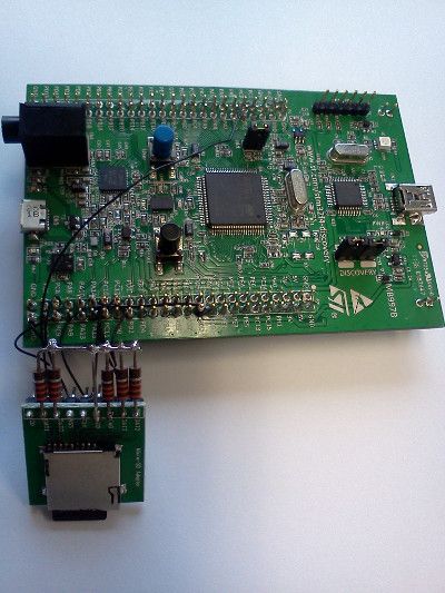

I have a class 6 card, so I just configured my clock at 6MHz which I verified on oscilloscope.Is it normal that my clock is not square but more of a sinusoid ?For my wiring,I use this socket >> I plugged the 4 data lines(D0, IRQ, P9 and CS as D0, D1, D2 and D3 in SDIO), the CMD line (DI), VCC at 3.3v, COM and GND to the ground and CD on PC2 as Card Detection.I don't think I need to plug WP so I left it unwired...Thanks a lot !- Mark as New

Do you have the pull-up resistors?
‎2012-08-10 9:33 AM
Hardware you mean ?
If so, no I don't.Should I put some for the data lines ?- Mark as New
‎2012-08-10 10:42 AM
Yeah, the ones I told you about 6 or so posts ago on this thread.
And several other threads around the SDIO/SD Card topic within the last couple of weeks.[DEAD LINK /public/STe2ecommunities/mcu/Lists/STM32Discovery/Flat.aspx?RootFolder=/public/STe2ecommunities/mcu/Lists/STM32Discovery/STM32f4-Discovery SDIO problems&FolderCTID=0x01200200770978C69A1141439FE559EB459D75800084C20D8867EAD444A5987D47BE638E0F¤tviews=123]https://my.st.com/public/STe2ecommunities/mcu/Lists/STM32Discovery/Flat.aspx?RootFolder=%2Fpublic%2FSTe2ecommunities%2Fmcu%2FLists%2FSTM32Discovery%2FSTM32f4-Discovery%20SDIO%20problems&FolderCTID=0x01200200770978C69A1141439FE559EB459D75800084C20D8867EAD444A5987D47BE638E0F?tviews=123 Five pull-up on DATA and CMD lines, of the order 33K or 47K. Without them stuff fails.https://docs.google.com/open?id=0B7OY5pub_GfIaUozb1VsY3Flb1E

Sorry about that, when you told me about the Pull Up resistor, I thought about the GPIO...
Thanks a lot, I'll try that tomorrow ! Your read me.txt is really helpful !I thought the wiring couldn't be wrong since with my own code I manage to write in the Card and read it back with the stm32. I thought my problem was just FatFs !

I've put the pull-up resistors and checked my wiring again, still nothing. I've read the post you linkedIf I just try to open/create a file in the sd card, it returns FR_OK, if I try to write in it, it returns FR_DISK_ERR (which is logic since no file has been actually created if I check the sd card on my laptop). The clock frequency is 6MHz (for my class 6 SDC). The VDD is 3v...I don't understand. Could it give FR_OK when creating file if it can't create it ?Thank you.
