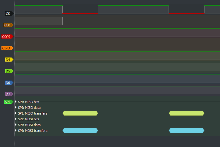

When I look at this with my logic analyzer, I am seeing this:

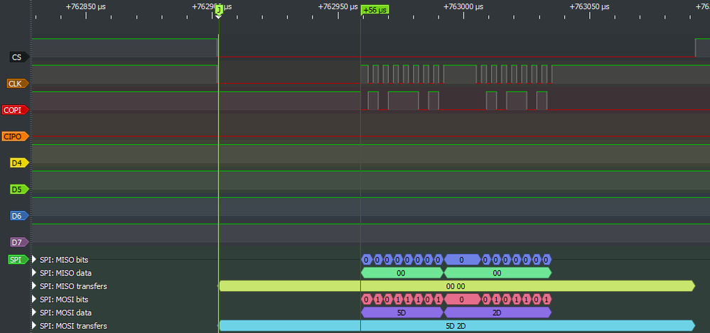

0693W00000Y9UtyQAF.pngAs soon as CS goes low, so does CLK. This doesn't make any sense to me because they are completely independent of each other. This causes an issue with the data. I am expecting the first byte to be 0xBA (10111010), but instead it is 0x5D(01011101)

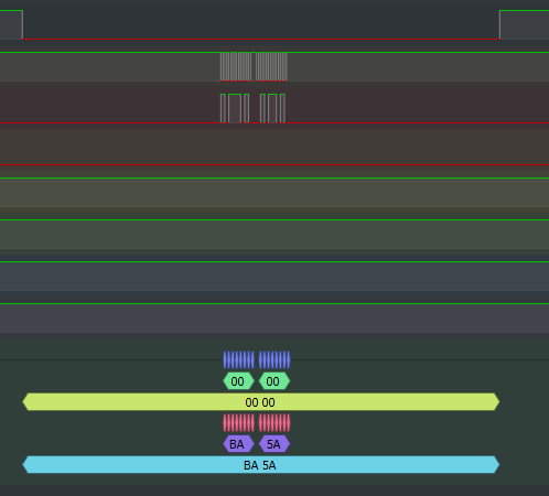

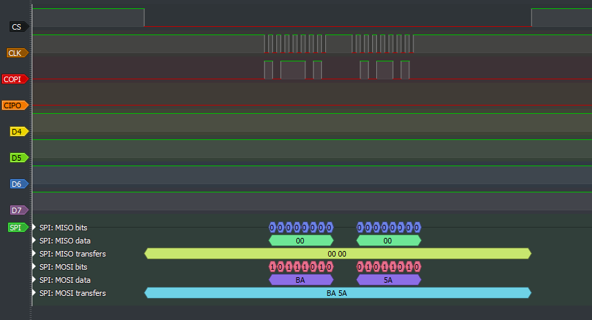

The equivalent output on the Arduino looks like this:
I just set CS to low, without an SPI transaction the same thing occurs:
However, this seems to begin acting normally after the first "write":
I thew a 10K pull up resistor in there, and it's still being drawn down.

S.Ma
Principal
If this is an STM32 Nucleo board, there is an LED on SCK. You need to disconnect it by solder bridge or jumper depending on the board schematics, if this is the confirmed root cause.
