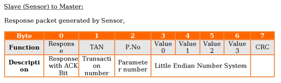

Communication Protocol
The protocol for the communication is as follows.

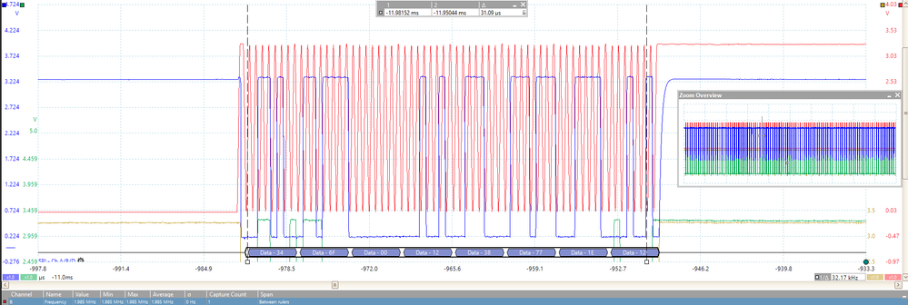

From the above picture (measured data from picoscope), the decoded SPI message from the MISO line is as follows,
0x34 0x6F 0x00 0x12 0x38 0x77 0x1E 0x12

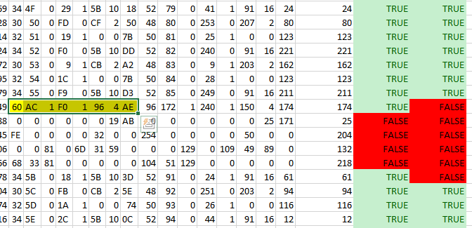

For example, take a look into the above highlighted transaction.
The decoded MISO message is 0x60 0xAC 0x01 0xF0 0x01 0x96 0x04 0xAE. The complete packet is shifted to the left by exactly 1-bit. If I shift the message by 1-bit to the right, I receive the following message -> 0x30 0x56 0x00 0xF8 0x00 0xCB 0x02 0x57. This is a valid transaction and the message holds true.

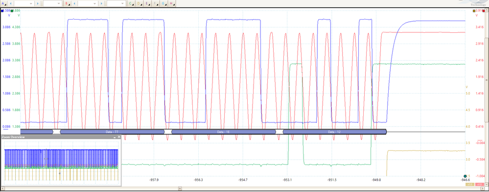

2020-08-12 2:13 AM
On second thought, observing MOSI vs MISO, CPOL/CPHA is probably correct.
The bit shift is most likely caused by the 'STM32 "seing" an extra clock; that this happens "when current consumption is on a higher range" indicates suspected noise/common ground issues.
The depicted SCK slew rate is suspiciously slow.
Try to get a galvanic isolated oscilloscope, placing the oscilloscope's ground clip as close to the STM32's ground as possible, and observe SCK (even stationary), directly on the STM32's pin, during the "high current" or transitions of it. Then try to observe the "glitch" as above. The probe+oscilloscope MUST be fast enough for the slave SPI capabilities, i.e. analog bandwidth above 100MHz and adequate sample rate.

Hi JW,
I did almost the exact measurement you suggested. I used special shielded cables, which were directly soldered onto the SPI connectors, with GND shield connected to the microcontroller GND. The bandwidth of the oscilloscope I used is around 70 MHz (12-bit resolution).
BLUE -> MISO
RED -> CLK
GREEN -> MOSI
Even I suspected such a "glitch" on the CLK line might be the culprit, but I was unable to capture this on the scope. There, the CLK signals looked fine. Even if we consider that such a glitch occurs on the CLK line, it should affect not only MISO but also MOSI. Right?
2020-08-12 2:31 AM
SCK is generated by master, so it's output (MOSI) is probably derived from internal version of SCK and unaffected (in STM32 it's not this way and MOSI is generated from a feedback from the SCK pin, but that's IMO a deviation, I've never met this approach before).
The SCK is suspiciously slow. slower than MOSI. Is there any way to make it's slew rate higher, maybe a pin setting in a master? Is there any extra hardware on SCK?
2020-08-12 3:00 AM
what is the idle state for clock? in picture it starts from low state but ends with high state. is this correct? make sure no clock edges are ignored.

prain,
Yes I've noticed that too, but CPOL=1, and there is a (barely noticeable) yellow trace which is probably NSS - within it, the clock is already high at the start, so that should be OK.
Also, the bit shift occurs midway in the message. Would the idle state of SCK the culprit, the shift would occur at the beginning.
