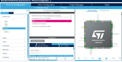

Firstly I'd like to say I have googled for examples and worked independently by reading ST docs and looked at the suggested topics before posting. I did begin to hijack another thread but I'll start one instead.
What a long and painful tradition printing with ST dev boards is!
My latest attempt is to follow this SWV tutorial for another board.
Apologies if it's something ridiculous, I'm new!
Having just tested the code before posting tonight, even with non blink related code commented out it has stopped blinking but still some help please :D
https://www.youtube.com/watch?v=sPzQ5CniWtw
Here is the code I am running.

Which involves rewriting the write() function. I also tried this write function
int _write(int file, char *ptr, int len)
int DataIdx;
for(DataIdx=0; DataIdx<len; DataIdx++)
ITM_SendChar(*ptr++);
return len;

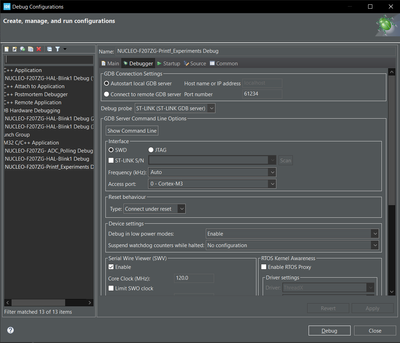

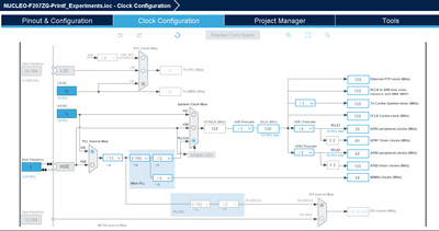

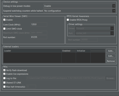

}My debugger is shutting down (RGB lights out) and sometimes has to be power cycled.
I have tried various core clock settings in the debug config tab.
here are photos of the clock page, debug config and RCC options.
Thank you TeslaDelorian for trying to help in the previously hijacked thread. Here is my clock info.

The HSI as PLL source, when HSE is available, is strange... but well let's try.

Looks good. Now, to begin seeing SWO output in CubeIDE: after you start the program and it hits the first breakpoint in the debugger: click the red button in the SWO output. First time, the ITM setup dialog will open. Check the checkbox for port 0 (it is used for the prints). Do not change other fields for now. OK out of the dialogs and run.

I started the program (debug button) and hit the red/record button in various SWV outputs before continuing. Not SWO as I have set u for SWV through the ITM.
No blink and no data.
Sorry I do realise that I could have added more context. SWO does not work. All of this is because SWO does not seem to work.
Is this correct? I am using a Nucleo-F207ZG
I just want to print if you know a simple way to print using SWO please explain. It sounds like more complex code is needed (simple printf commands do not work).
