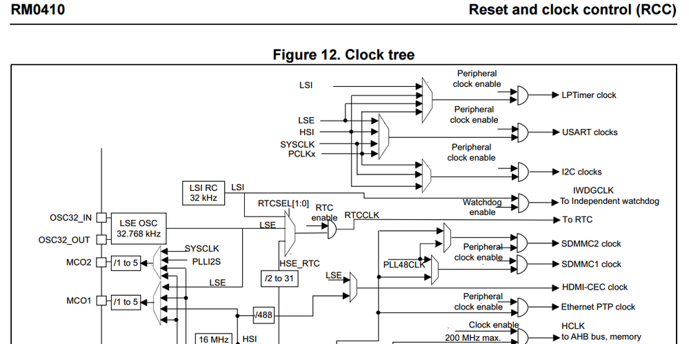

Digging in the spec, for STM32F7 the reference manual clock tree details shows:
So it is possible to inject SYSCLK directly to USARTs. If SYSCLK is 216MHz and as Clive said to use /8 oversampling mode, 216/8=27MHz. (RX bit scan 8 times oversampled). For sure a precise external crystal (HSE => PLL => SYSCLK) will be required to make sure the clock tolerances don't cause high BERR.
So it would be good to try it out with 2 Cube USART example on a Nucleo board and use an oscilloscope to confirm the bit rate between both Nucleo boards.
