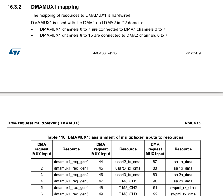

I want to use DMA on my stm32h7 board, but i can find which channel is used for what protocol ect.

it has this;
I want to use the SAI controller to read data from the AD7768 adc, so im looking at the sai1a_dma, and i can see its on the 87th mux input.

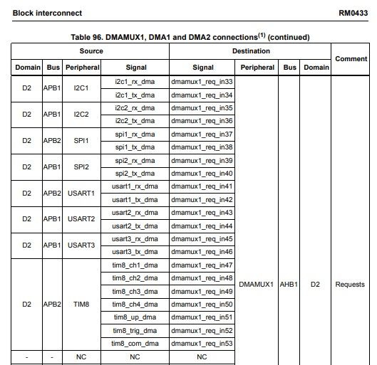

and also another list, but i cant make much practical sence of it.
On the f4 you have a clear table with each channel and stream, but i cant find anything like that of the h7.
Yes, i saw this list, and i saw that the sai1a_dma is on signal 87 of the dma mux, but to which channel does that translate?
waclawek.jan
To which you assign it in DMAMUX. That's what DMAMUX is for.
If you don't want any of the fancy stuff, simply write 87 into say DMAMUX1_C0CR.DMAREQ_ID, and then your SAI_A DMA triggers stream 0 of DMA1.

aaah thnx, at first i thought there were preassigned dma channels for peripherals (like, i thought, the f4).
thanks
