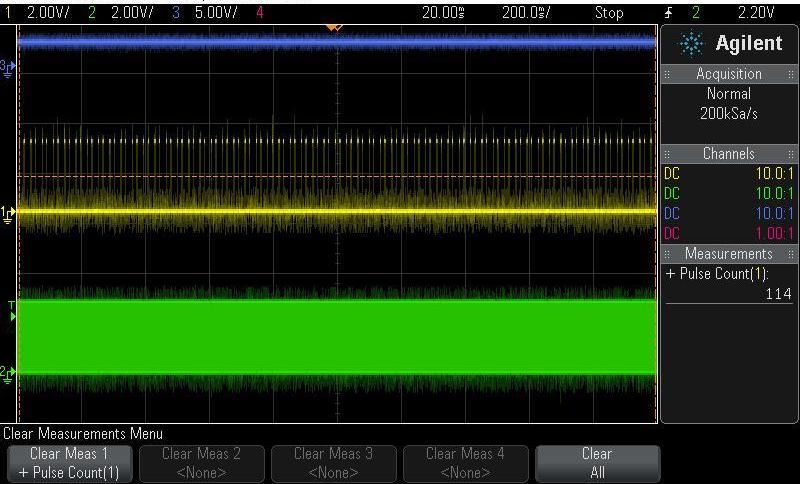

this is the code to set pclk at 272khz(slow mode)CAMERA_IO_Write(DeviceAddr, 0xff, 0x01);
CAMERA_IO_Write(DeviceAddr, 0x11, 0x20);
the number of lines =114<120 lines

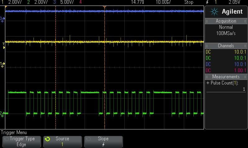

‎2014-05-07 8:02 AM
‎2014-05-07 8:51 AM
I would be more confident in this measure when the scope capture shows both edges of the VSync signal.
Show us the capture that measures correctly the 240 lines in QVGA mode.
