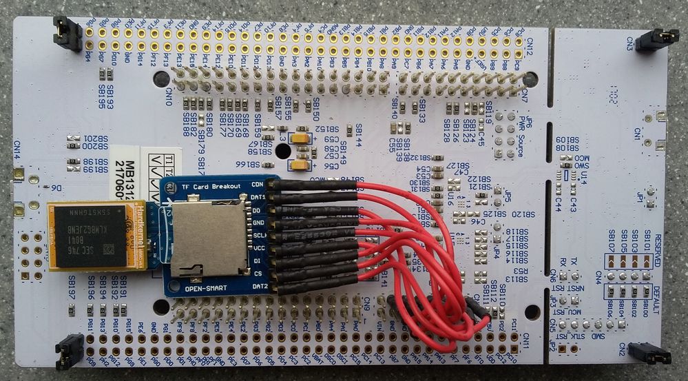

Ok, so making progress on this, I have eMMC running on L4 parts
Currently have builds working on L496ZG-NUCLEO, L4R5ZI-NUCLEO and STM32L4R9I-DISCO
Lukasz is tinkering with a 20-pin ''eMMC HAT'' that will plug onto the NUCLEO-144's SDMMC header
