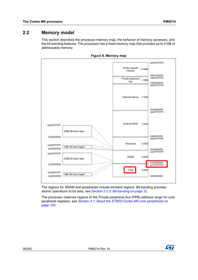

But the Cortex M4 reference manual says that the Code region, that can be accessed via ICode and DCode, end at 0x1000_0000... I still don't get it.
waclawek.jan
My copy of that manual says, that Code ends at 0x1FFF'FFFF:
(and the ARM manuals agree to this).
> SRAM1 is accessible via DCode to load data, which does not have 1 cycle penalty as accessing data through System Bus does
Only if you access it in the area starting at 0x0000'0000, if SRAM1 is mapped there in SYSCFG_MEMRMP.MEM_MODE.
As you access both SRAM1 and SRAM2/CCMSRAM at addresses >0x2000'0000, both are accessed through the S-bus of the processor. However there may be different arbitration schemes at the bus matrix for each of these memories (e.g. "don't release until other master requires, allowing faster sequential access for one master but imposing higher latencies when masters interleave", vs. "release immediately, resulting in uniform 1 cycle penalty for each access of each master") at the bus matrix, or these memories may impose different waitstates at their own. ST does not publicly document these details at all.
You can try to speed things up by reading multiple pixels at once (as a word, or maybe even as a double-word), or perhaps placing the palette data into the CCMRAM accessed through its 0x1000'0000 address (i.e. through D-bus).
