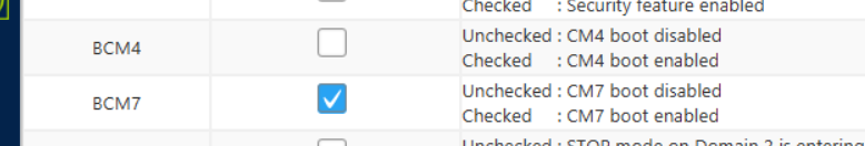

I've taken over this project that is using the STM32h755 CPU. The software is not currently using the Cortex-M4 processor inside the chip. I'm reworking the software so that it will be able to use it sometime in the future. But, until then, I was hoping to "turn off" the M4 to save power.
I think there is something about disabling the clocks in the RCC register for the M4 cpu. But, uncertain as if that is the propery way to go about this.

You can disable CM4 with option bytes with CubeProgrammer, so you will be in Single core config:

Thanks. As I'm new to the STM32 line, I was unsure where to find it.
