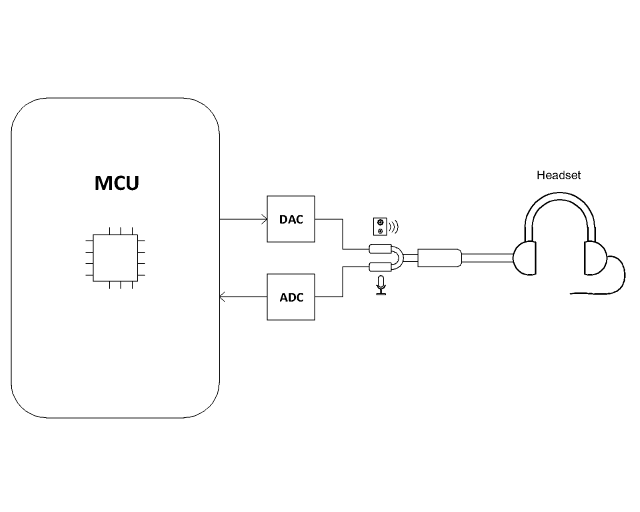

I am trying to figure out how to use the built-in ADC and DAC ports of my Nucleo-F446RE board. My end goal is to record and play a block of sound using the Hal-library. The setup is simple, I want to connect a built-in speaker and microphone of a headset to my board so that I can stream sound from one end to another. The application is useless, just getting started with audio devices and learn how to use the Hal-Library.
0693W00000UnEWnQAN.pngWith that said, I want to know if I can directly interface the headset pins to my Nucleo board, or I do need a specific circuit, perhaps an amplifier circuit, to do so without damaging any of my devices. It is worth to mention that I don’t have much experience with electronics, so if I do need a such circuitry, please recommend me a link or a part number of a ready to use breakout board that allows me to do so without the need to build it form a scratch.

Yes, you need an amplifier, both for the headphones and for the microphone.

Nucleo boards are not designed for audio application. But there are many ST evaluation boards that support audio, using specific IC - codec. You can even download schematics on the ST product page
