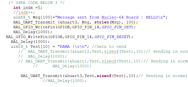

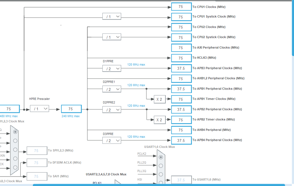

_legacyfs_online_stmicro_images_0693W00000biInSQAU.pngi can not get full text msg ,some alphabats are missing each time .how i can solve this ?

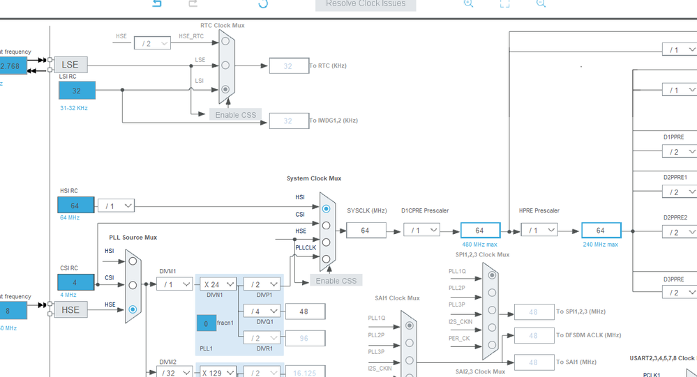

Probably not an issue with the code you're showing, but elsewhere.
W​hat chip and board are you using?
Which clock source? Is that properly calibrated? Which UART and pins, connected to what?
W​ould suggest sending 0x55 'U' data patterns constantly and inspecting signal timing on a scope.

Focus on the cause, not the symptoms. You're not looking in the right place.

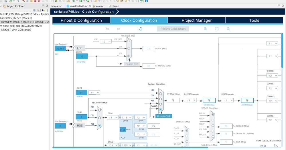

Here perhaps the timing, whether MSI or HSI clock sources use the right calibration values, and how accurately they are clocking.

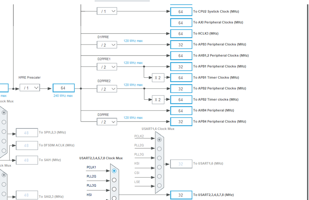

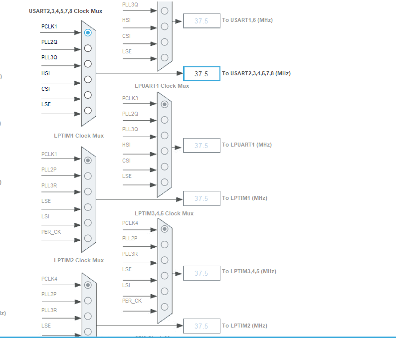

this is the same question asked by me
these are the clock setttinfg .but am doing wrong in clock side?

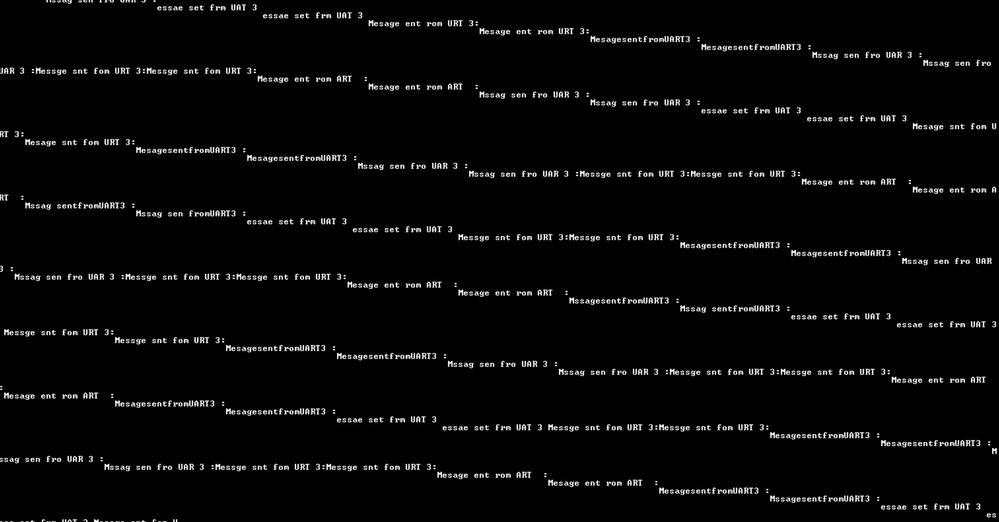

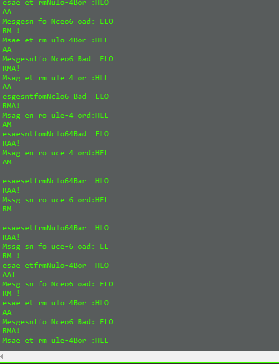

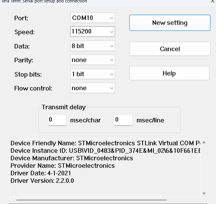

_legacyfs_online_stmicro_images_0693W00000biSsHQAU.pngthese are the output in which alphabats are missing
_legacyfs_online_stmicro_images_0693W00000biSp9QAE.pngthese are tera term settings
If this board is using an ST-LINK/V3 watch that HSE BYPASS is likely 8.333 MHz not 8.0 MHz​

this is the solution ,my code is working with this parameters
thank you ,my code is working ,setting are mention below
